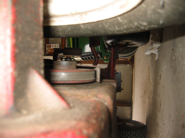

I played around a bit with getting a bit more speed on My L107.  I finally settled on a 3" pulley on the tranny.  By experimentation found a belt and the speed in 3rd was good.  Problem...couldn't shift it.  Went back to original.  Solution would be to modify the belt guard to keep it close to the new smaller rear pulley...haven't gotten around to it yet.

pfrederi
the belt has to press against the lower edge of the belt guard when the clutch is disengaged.  If it has to drop too far to the belt guard it won't fully disengage from the engine pulley and will keep moving, spinning the gears making shifting impossible. The picture tries to show how close the lower lip of the guard has to be to the pulley to force the slack up to the engine when you disengage clutch.
  Engine pulley is 2-1/2.
