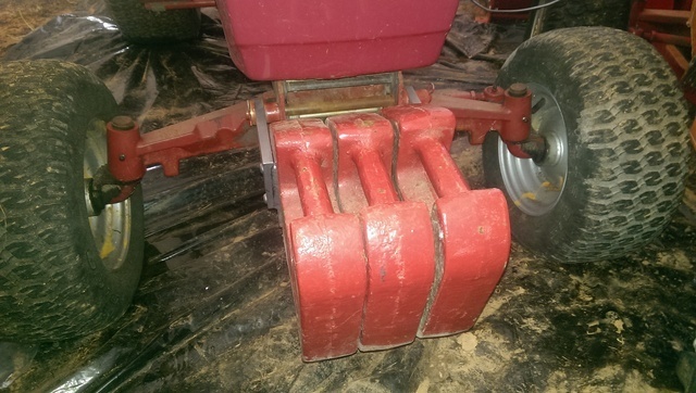

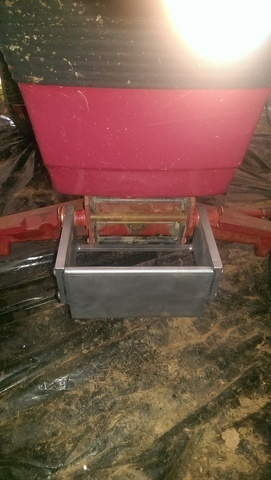

I honestly believe Wheelhorseman1000 has the best rear receiver hitch setup (I don't personally have one but looks the part from what see and read here) for our lil red tractors but as most have stated in other threads on our forum it'll handle just about everything we throw on it or tow with it ,with the exception of a light front end where you'll need some ballast weight out front like my front weight hanger bracket(I don't make these to sell but I have thread with blueprint to have 1 fabbed up) hope this helps on your endeavors,Jeff.

Thanks also for posting the photos, now I know what a proper front weight system looks like.

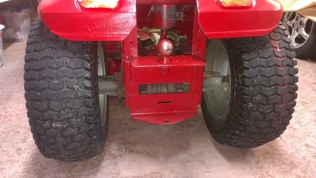

Here is a photo of the hitch I built for my 244, and it moves the boat and trailer very well. It does get a little light in the front end, but I think leaving the deck on helps a bit for the counter-weighting.

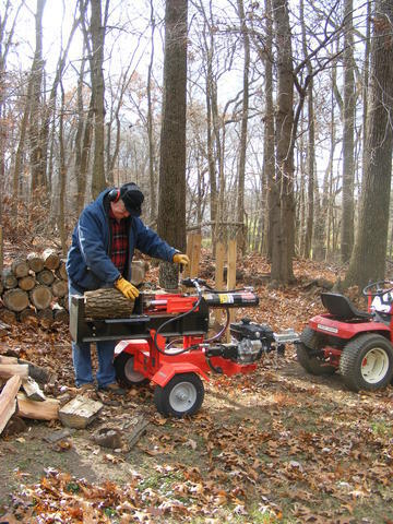

Here is my C-105 being used to pull my log splitter. It has Scott's/Tom's 2" receiver hitch mounted being used with a HF 6" Drop Ball Mount Hitch, actually giving a 6" rise. I find the receiver hitch to be very useful as I can tow equipment, use my HF crane, pull my Cyclone Rake using a solid mount instead of their rinky dink solution for a WH, and attach a 2,500 pound winch.
