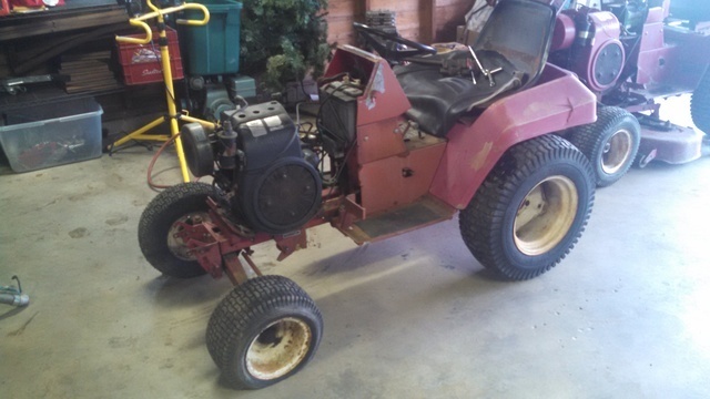

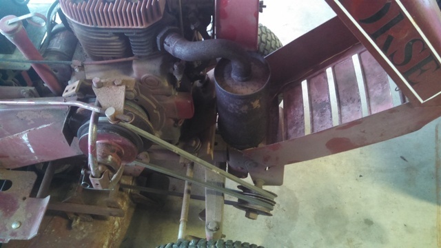

Last weekend I drug home a C-125 parts tractor to molest for parts for my C-161 that I got going a while back.  It had all the things that the old 161 was needing: good seat, good clutch plate, better tires, and most importantly, GOOD ORIGINAL NELSON MUFFLER!  Someone long ago put one of those stupid pepper pot pieces of crap on it and I nearly went deaf when I mowed with it for the first time last weekend.
Just got the muffler swapped over, and HOLY CRAP you never realize how loud something is until it's not loud anymore.  What an insane difference that thing makes!  I'd say at least a 40% reduction in noise.  That muffler alone was worth the $100 I paid for the parts tractor.

Glad the new addition solved the problem! Much cheaper than $5,000 for a pair of hearing aids........   :lol:
DorkFish
I basically bought a discounted muffler and got a whole tractor with it for free!  :banana-rock:
  • Like 4
Pollack Pete
I hope you bead blasted and painted that muffler with hi-temp paint before you put it on.Next time you need one,you'll probably never find one.Especially one that cheap.

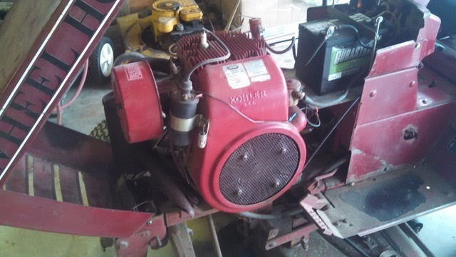

      Well fellas since I had to sell off my Wheel Horses I felt like I didnt belong anymore. The Lambert and the Speedanza are cool but THIS IS a Wheel Horse Fourm. Well guess what....... Im back in ! Picked this up a little while ago. Saw it on CL and jumped right on it. Not a model I know anything about but it does say Wheel Horse on the side of it ! I am so excited to have it and the best part is that it runs and drives!!! It does need some work... I think the hydro is leaking as a saw a puddle of oil on top of the deck. Checked the dip stick and was hardly any in there. When you raise the deck it seems to come up higher on one side then the other. Seat is horrible, someone glued vinyl on it. Front head light lens busted, rear one is busted and no lights work. came with wheel weights for the rear but nothing else. Still trying to figure it out. I just got it home and off the truck. As usual any info I would love to hear about it. I dont know the year, I believe thats a 16 hp Kohler, not sure but it runs really good. Not a fan of driving it by a stick, seems like something you have to get used to then maybe like. Right now it just seems funny but I only did a little lap in my yard. I think I got a smoking good deal on it that makes me even happier.
