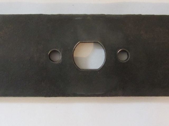

I have one original spindle (the center drive) of my deck (either a 5-1482 or a 5-1483) on my 1969 GT 14 (1-7441). When the deck was new it had all three spindles the same (8139), however the outer two spindles got replaced sometime before I bought the tractor/deck some 35 years ago. The blade required for that spindle had the double D center hole, and the two 1/4" holes spaced 1 5/8" apart, center to center. The two smaller holes accept 1/4" roll pins inserted into the spindle hub.

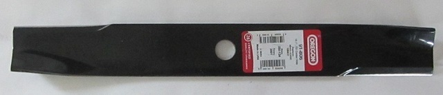

At one time all I had was one set of blades which proved inadequate to get me through a mowing season. So, one day I hauled in what I had along with my parts diagram and list and asked if she had any of the double D three holer blades. To my amazement she had what I needed and could also supply the other two blades which were dead ringers for the old style 6758 blades except they had no roll pin holes and had a 3/4" round center hole which would fit my newer outer spindles.

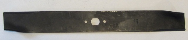

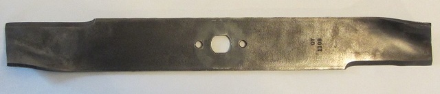

The only markings on the blade is QY 1109. If somebody know blades real well, maybe this mystery can be figured out as to who the manufacturer is.

The elusive three holer double D, 16" mower blade:
Used example purchased from Bill's Engine.  Stamping: QY 1109
New example purchased this week.  Stamping: QY 1109

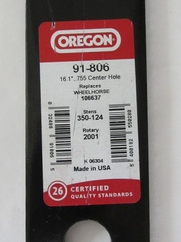

Oregon 91-806 for my outer two spindles
Close up of the Oregon sticker
