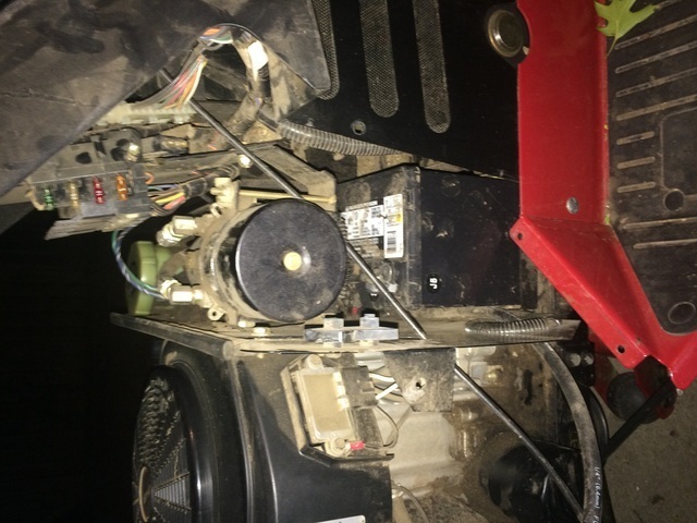

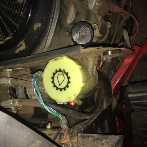

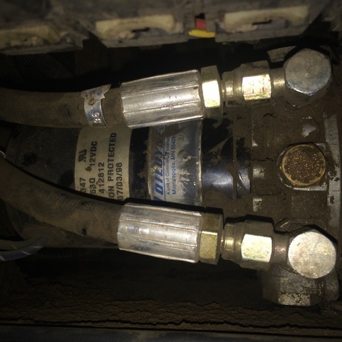

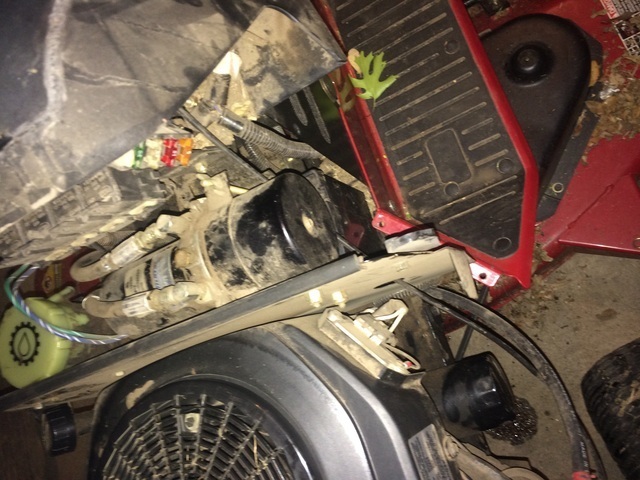

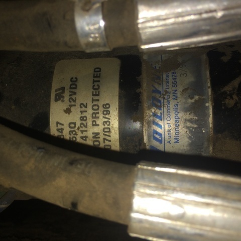

HELP.... As I started to mow I noticed that the deck would automatically lower its self after I had it set. By the time I got done mowing it would no longer raise up when I hit the button, however when I hit the button to raise the deck the pump makes a noise but no action. Anyone know what could be causing this, how to fix it? Before I started mowing and probably 3/4 of the way through it worked fine as far as lowering all the way down and coming back up.

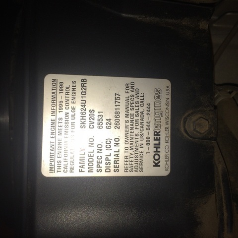

The CV20S-65531 shows up as being used in the 2000-2003 model 270-H using 72108 for a model number. The 2606811757 Kohler serial is from their 1996 production and would normally land on a 1996 or 1997 model tractor. Either the engine is not original or there is a mistake in the data. No data decal under the left front corner of the seat?
This list of manuals may help
http://www.wheelhorseforum.com/search/?type=downloads_file&q=72108
78260 is the model number of the 48" mower deck
This manual is for the hydraulic lift
2000 model 270-H operator manual plus links
Garry
casexx18
Hey Garry I was able to find this under seat
Interesting that Toro has the CV19S and CV20S using the same 65531 spec number. Guess that proves they are the same engine.

Thanks for the help. After I added some automatic transmission fluid to the pump I was able to get the deck to lower/lift again. But I do have a leak coming from somewhere which is why it quit working in the first place. Hopefully I can find the leak and it will be an easy/cheap fix.

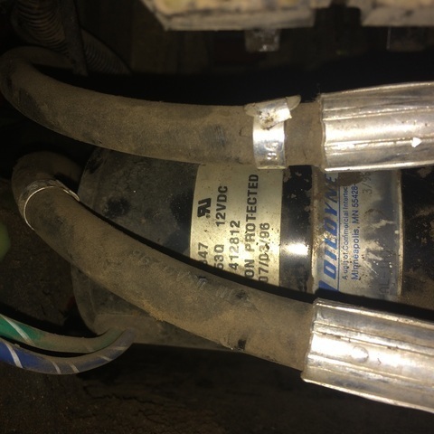

Garry, I see this is an old thread but I thought it best to add directly to this one.  I just bought a:
Model 72102 Ser 8900682  Model and serial was shown to be a 1998 269H
Engine:  Kohler CV20S, SPEC: 65531  Serial 2801920751
Googling the CV20S and Toro or Wheel Horse shows lots of 269H.  Not sure why Toro would put a 20hp in a 269H that was sold as a 19hp tractor.  This one appears to be original but who knows.
