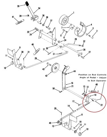

There isn't a 'clutch' per se, but a belt release mechanism that is adjusted by the LEFT side foot pedal.  There is a rod and trunion (#22) attached to that pedal and you adjust it by turning the trunion in or out on the threads of the rod.

I tried that but it didnt help any other ideas?
