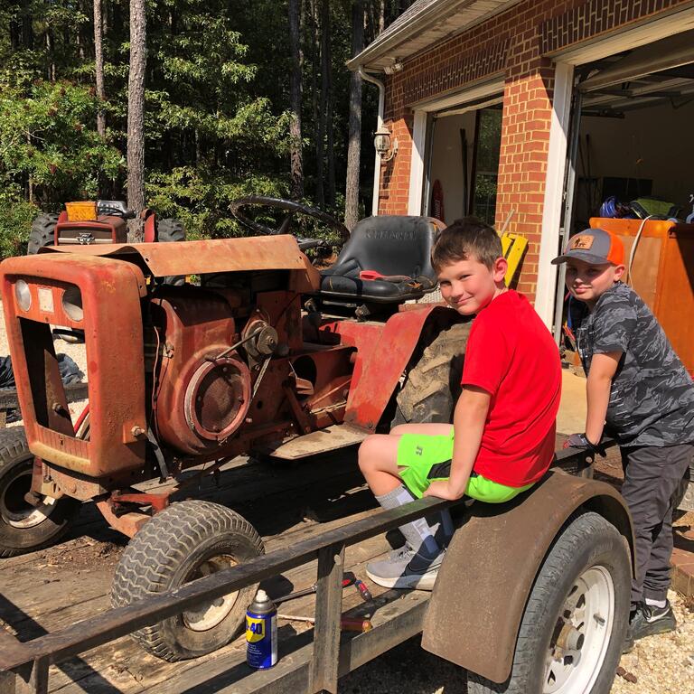

Gor_Cabot1@msn.com
I bought an old WH 1054 years ago with the intent of making it a restoration project out of it.  Life had other plans and time slipped by with the tractor just sitting in the yard.
Now 15 years have gone and I recently lost one of my sons to a brain tumor.  His son, 11 years old, asked if we could maybe restore the tractor and either pull or show it.
Welllll, I'm going to make this happen, but I have no real experience with this stuff.  Overall I see my priorities as getting the electrical system in order and the fuel delivery restored.
Can anyone tell me how to get the old tank out so I can either clean or replace it.  It looks to be pretty snug in it's place under the seat!  I certainly would appreciate any tips you guys could give me.

953 nut
So sorry to hear of your loss.                                   :WRS:
That looks like a great grandfather/grandson project.          :text-coolphotos:               To remove the gas tank you will need to remove the transaxle. To get at the top righthand bolt for the transaxle it is best to remove the hydraulic lift cylinder.
Post a few pictures as you go along, we are hear to help.  Your tractor may be a first generation 953, what is the serial number?

Gregor
:text-welcomeconfetti:  to  :rs:We like to see LOTS of pics. This may help you along the way. As said above, a serial number would help. The serial number plate should be located on tower under the steering wheel.
