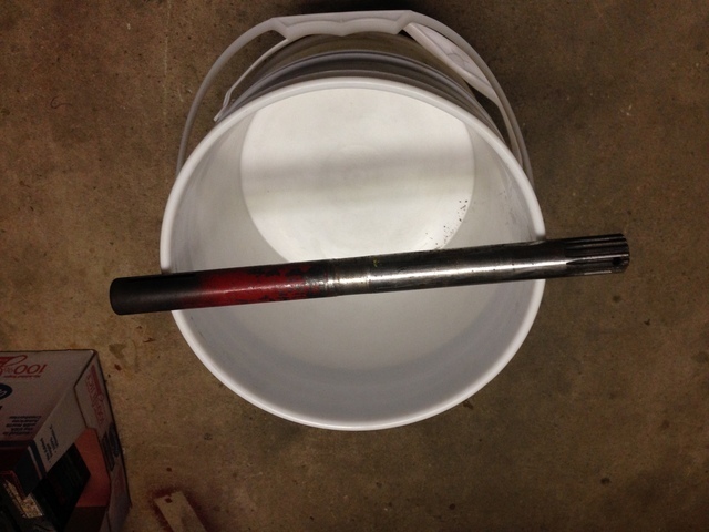

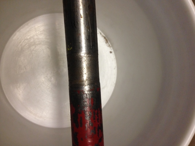

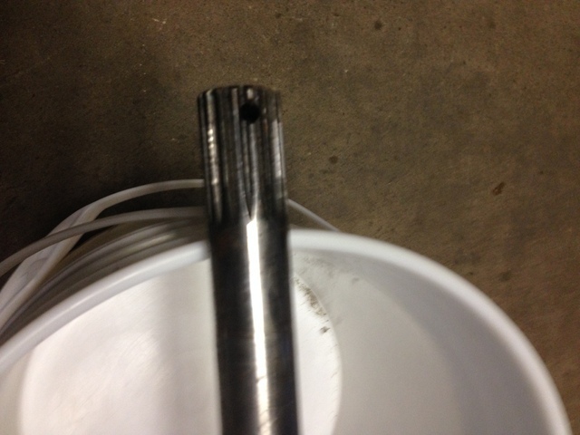

Lane Ranger 11,059 #5 Posted March 19, 2016 As Stevasaurus says you should be able to get one from @racinfool40 (Mike Biser). Mike took one of my old 1054 transmissions and upgraded it to an 8 pinion differential in the transmission (taken from later models Wheel Horse tractors) to strengthen the differential in the 1054. The 953/1054 axles are longer than other Wheel Horse transmissions and the first that were 1 1/8 round. Here are some pics of an old Wheel Horse 1054 axle. The second pic is a closeup of the splined end of the axle that mounts in the differential. The third picture is of the worn area on the axle that happens as the needle bearing in the case sidewall wears. The read painted area is outside the transmission case. A very big Woodruff key goes on the hub side of the axle too! 2 Share this post Link to post Share on other sites
