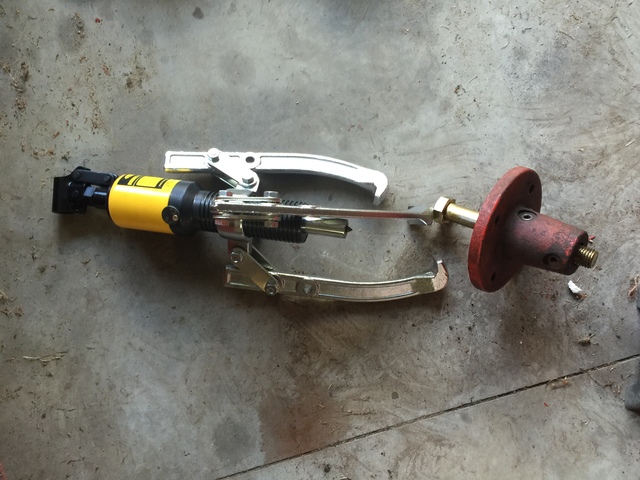

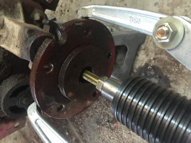

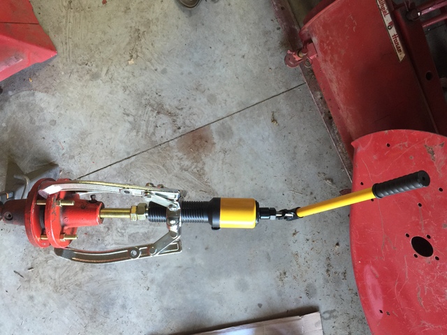

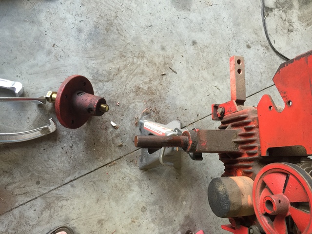

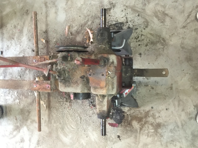

Aldon 4,828 #1 Posted March 17, 2016 I just got done wrestling off a drive pulley, fly wheel. Ordinary pullers did fine. Then I spent two days fighting with GT14 hubs. Once again the hydraulic puller has risen to one of the best purchases I've made this past year. It took all 10 tons of muscle as well as heat and Kroil along with my own stubbornness but the hubs lost the fight again. 6 Share this post Link to post Share on other sites
squonk 42,554 #2 Posted March 17, 2016 EEK!! Get that Fram off of there! 4 Share this post Link to post Share on other sites
Aldon 4,828 #3 Posted March 17, 2016 11 minutes ago, squonk said: EEK!! Get that Fram off of there! Indeed. That's an old pic. It's the parts tractor being disassembled. BTW, that tranny is toast. I may be able to use it for rebuild. 1 Share this post Link to post Share on other sites

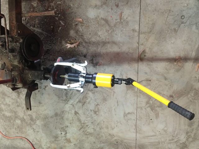

Aldon 4,828 #6 Posted April 26, 2016 Bought a parts C105 for some brackets I needed. But it's in the way so I had to tear it down to clear my workspace. It takes longer to assemble and break down the puller than it does to pull hubs. Totally amazed that it took me so long to bite the bullet and buy this tool!!! 3 Share this post Link to post Share on other sites

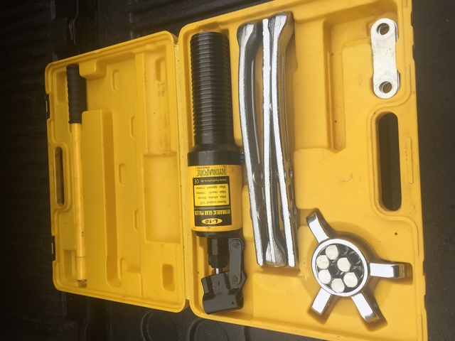

pfrederi 18,334 #11 Posted October 12, 2016 I got mine today...neat tool can't wait to use it. However, who the heck wrote the instructions. i have run in to Chianglish directions before but these are the worst I ever seen/tried to read.. 2 Share this post Link to post Share on other sites
Aldon 4,828 #12 Posted October 12, 2016 Agreed. I only glanced at them a moment and realized I would be more confused using them than just figuring it out on my own. Mine is weaker than when new. Need to figure out how to add fluid to top it off. But I have pulled 3 or 4 sets of hubs and 2 or 3 flywheels. If it was to die next time I use it, I figure it was still money well spent:-) 1 Share this post Link to post Share on other sites
