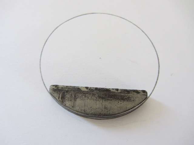

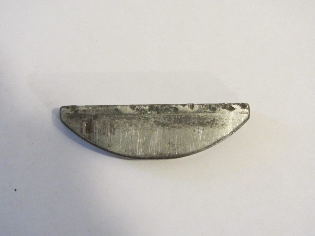

As many of you know, I've been in a prolonged battle with the rear hubs, woodruff keys, and oil seals on my 1969 GT 14, Model # 1-7441.
I'm to the point of installing the new SKF oil seals today as soon as I can round up one more PVC fitting to properly size it to my seals for tap in installation.
