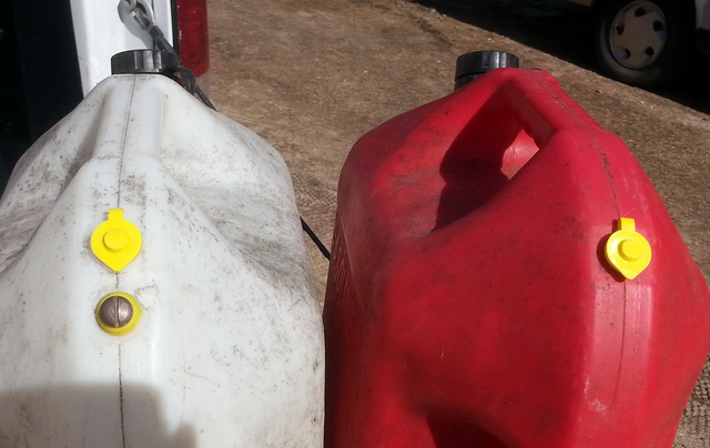

DennisThornton 4,771 #20 Posted March 13, 2016 On 3/5/2016 at 10:10 AM, DennisThornton said: You got me thinking about all the cans I have missing the yellow plugs: Search eBay for " Gas Can Jug Vent Cap Blitz Wedco " I found: 10 Yellow Fuel Gas Can Jug Vent Caps Shipped for $7. Just the vent cap assemblies: This listing is for TEN Gas Can Vents. It will fit Plastic and Metal Fuel Jugs such as Blitz, Wedco, Scepter, Essence, Midwest, Eagle, Chilton, Briggs & Stratton, Rotopax, Gott, Rubbermaid, Sears Craftsman, Anchor and Koplin. You will have to drill a 31/64" hole into the can, then push the vent into the hole. These caps can be installed on any fuel can in order to provide a vent and allow faster flowing fuel. I ordered, I received, I installed: They work great for cans that didn't have a vent but I expected to replace the missing/broken/existing vents. No go! The replacements are a bit undersized compared to 4 I had so I just screwed the existing and added the new. Some tips. Drill fast with a light pressure and chamfer the edges before installing. They come open but close the vent and push hard maybe even a sharp rap with a light hammer. I had hoped to replace but I'm still pleased with the purchase. I should note that they seem no better but no worse than the originals. 1 Share this post Link to post Share on other sites
