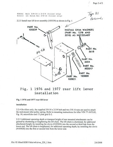

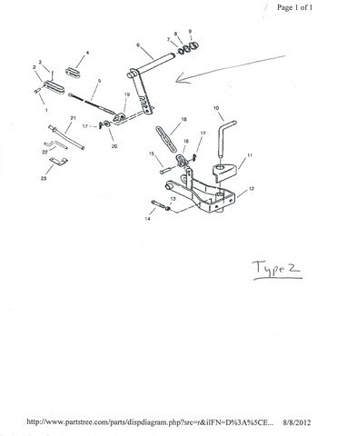

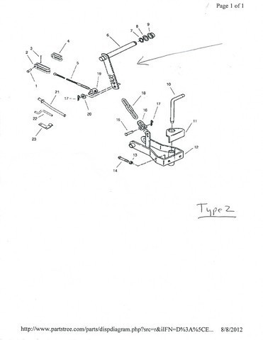

Lane Ranger 11,054 #2 Posted March 4, 2016 You should be able to the big thing is that you will need the correct rockshaft piece for the rear seat pan on the C-120. My 1979 C-121 has a rockshaft that is just like my 1993 314 on it. The pre-1978 tractors have to have a different part (rear rockshaft). I believe there is a Service Bulletin on thsi matter . I will se if I can find it and send to you! 3 Share this post Link to post Share on other sites
Lane Ranger 11,054 #3 Posted March 4, 2016 (edited) The Type III rear tiller rockshaft piece is what you need to use a tiller on a 1977 C-120 Wheel Horse. The Type II is what I have on my 1979 C-121 and my 1993 314 Wheel Horse . The other parts for the installation can be bought thru Toro still and you can look up Clevis Type A Hitch 8-5515 to determine what you might need and prices. Edited March 5, 2016 by Lane Ranger Share this post Link to post Share on other sites

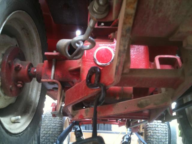

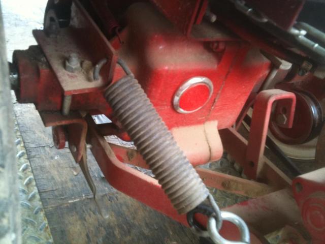

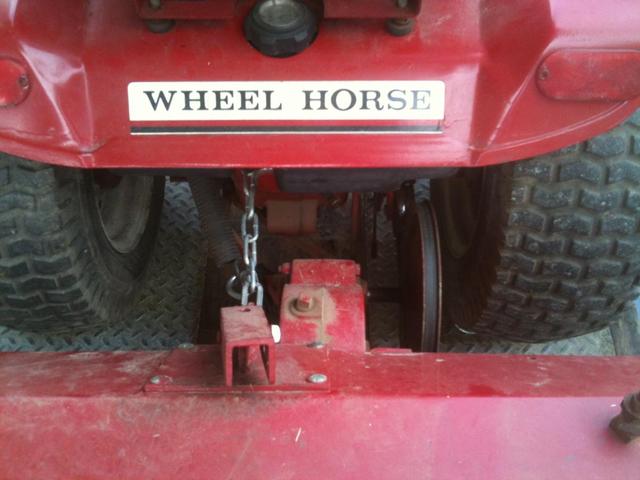

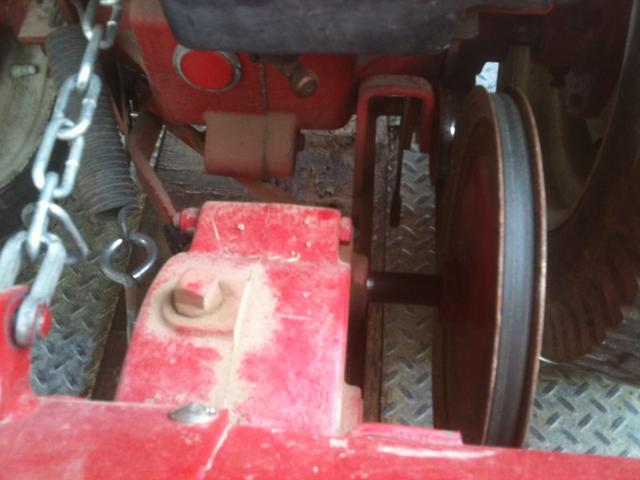

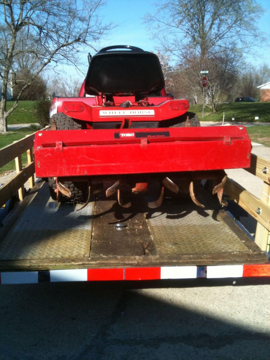

Ironhorse1077 21 #4 Posted March 4, 2016 Thanks so much for your information-filled reply! I had the tiller on a 1077 last year but had a knowledgeable friend help install it. I have to go out and look at it again and look through the ol' box o' parts to see what I have. The pictures should prove very helpful when I get to installation..... 1 Share this post Link to post Share on other sites

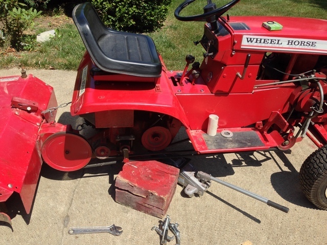

can whlvr 993 #5 Posted March 4, 2016 I don't have a rock shaft for my tiller,i put a small pulley that the cable turns down towards the tiller,i think you can kind of see it here in this pic,its not as good as a rock shaft but it works fine for me,heres a pic 2 Share this post Link to post Share on other sites

can whlvr 993 #8 Posted March 5, 2016 I believe it is to get the pull affect from higher up,before I had the pulley it would wear the cable till it broke, 1 Share this post Link to post Share on other sites
c-series don 9,177 #9 Posted March 6, 2016 I went through many cables when I had several gardens to rototill then I found out about the rockshaft after I stopped doing that. I think that it would be especially helpful with a manual lift. Not sure though. Share this post Link to post Share on other sites
Lane Ranger 11,054 #10 Posted March 6, 2016 (edited) Tiller Service Bulletin file:///C:/Users/Lane/Downloads/WH61-90%20%23220%20Tiller%2036in%20Hitch%20Conversions.pdf Edited March 6, 2016 by Lane Ranger Share this post Link to post Share on other sites
