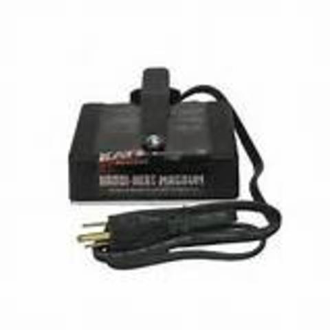

If it bothers you a lot get on of these 300 watt magnetic block heaters from like Napa and others. Stick it on the bottom of the hydro. I use these all the time on my Sunstrand hydro and the oil res on my Power King loader. They work great! Don't forget to remove them when you use the machine! :)

The problem with using the recommended motor oil is that the viscosity, even synthetic, is still pretty thick compared to ATF fluid used in a Sunstrand. I don;t think that I would use anything but the recommended fluid though. An engine has combustion creating heat so the oil thins quicker. The Eaton 1100 really needs an external electrical heater like Mike suggested for consistent cold weather operation.
