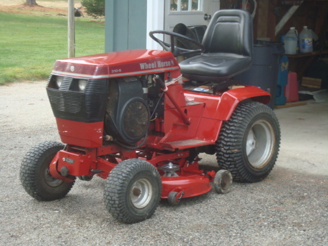

I'm no ace mechanic. I'm lucky to have the same dealer twenty mins. away that I bought mine from 30 yrs. ago.   It sound like you have a sweet tractor.  If it's what you like, by all means spend some money and get her fixed.  I swear, I'll never give mine up.  I spent $2400 for mine new and another $2200. in repairs since '86.  Does this tractor look like a beat up pile of metal?  This Wheel Horse has out lasted everything in my neighborhood 5 or 6 to one.

  The way I see it we are all trying to do our daily chores and depend on equipment made as far back as the 60's. Your D is probably a 70's vintage machine making it close to 40 years old.
  I don't know your budget....but I feel that a second machine (Wheel Horse of course) is a necessity because stuff happens and sometimes even our favorite brand of tractor craps out (like yours has). I have two machines set up for winter duty, my primary plow tractor and a backup.
  Get yourself a 300 or 400 series machine...much newer than your D series and it should be way more dependable. Then you can get the D straightened out while mowing with the spare tractor.
Mike.....
  • Like 6
