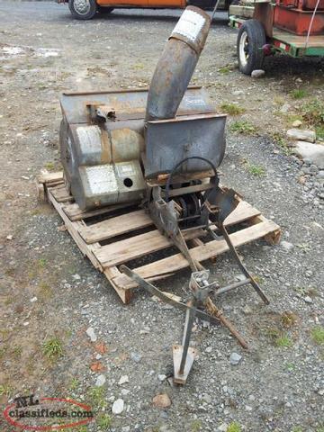

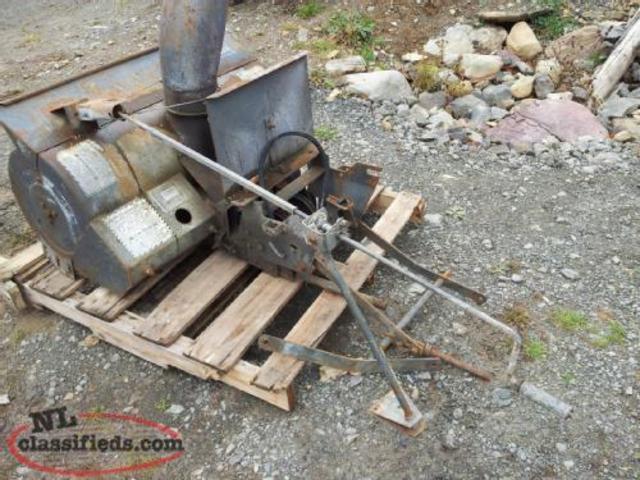

Sean Walsh 0 #1 Posted February 21, 2016 Hi, newbie here, I am new to the wheel horse world and have recently purchased a 93 520H, which I am doing a semi restoration.. The wheel horse is not very common around hear nor is the attachments. Any way, to the point, does anybody think that I can modify a 3' sears snow- blower. This one is forsale near where I live.... Thanks for any input Sean Share this post Link to post Share on other sites

squonk 42,007 #3 Posted February 21, 2016 That blower looks old, heavy and over-complicated. I'd keep looking for the correct blower Share this post Link to post Share on other sites

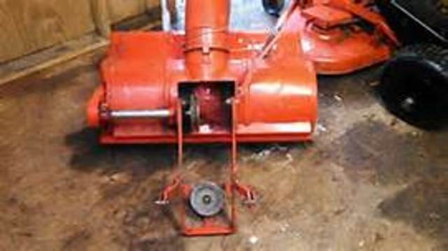

squonk 42,007 #5 Posted February 21, 2016 It wouldn't be cheap, but I'd buy a blower in the states or Canada and have it shipped in. I think you would be much farther ahead. You don't want to be fixing/repairing a blower in the middle of a storm with a couple of feet on the ground. The only other alternative I can think of is an Allis-Chalmers/Slimplicity blower. They are simple in design, somewhat lightweight and compact. They work well. I had one years ago. It was meant for a horizontal engine tractor and I made it work on a vertical shaft engine model Share this post Link to post Share on other sites

ericj 1,578 #7 Posted February 21, 2016 (edited) not including how to mount it on a 520, it would also be hard to get the belts to work, you would also need a gear box of some sort to get the belt to fit at those angles, and as said above probably not worth it, but if you are good enough or have somebody to work cheap enough on it any thing can be done with a smoking wrench and a welder i guess. eric j Edited February 21, 2016 by ericj Share this post Link to post Share on other sites
