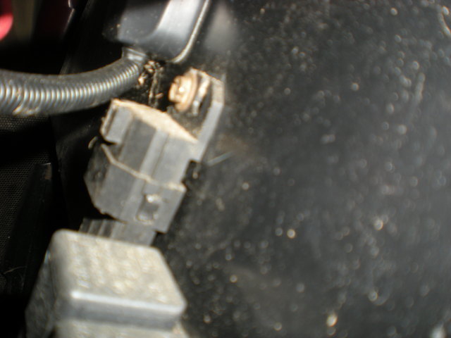

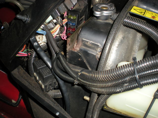

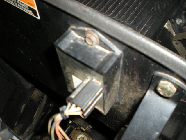

Don, it should be on the firewall. The five wire (1st photo) is about the size of a deck of cards, and the three wire (2nd photo) is a bit smaller. And then there is the diesel! It actually is not as bad as it looks.

John, thx for the tip.  I have the 3 wire version.   I will give a more detailed look in a couple of days.  I think all that is in this is an OP amp to drive the light and pull up or pull down resistors to set the voltage threshold.  Could be as simple as a corroded contact...or not.  Took me forever to find the module on the IPL-$80 ouch.  Have to go on the hunt for the OEM
