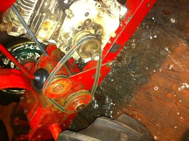

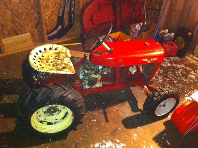

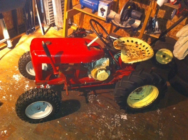

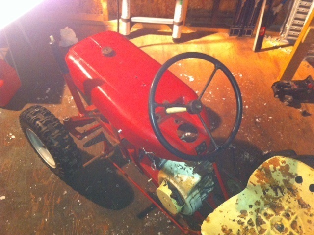

peigt14 19 #1 Posted February 14, 2016 need some help identify what I have in the below pictures. From looking at other threads on the site I have it narrowed down to a 61 suburban 401 with a replacement tescumseh hs40 engine. Just want to see if I am correct or not. I just got the hs40 back to life, fits tractor quite well and would like to keep it on there, my issue is I have a 9 year old son that is getting more anxious by the day to get on this thing and drive, before that happens I need a belt guard, right now the transmission pulley to the engine measures around 9 1/4" and the clutch to the engine around 5 1/2", there are a couple advertised on ebay and just wondering if would be lucky enough to get one that would bolt on. I was hoping that once I confirmed it is a 61 401 someone could measure to see how close this set up is. 4 Share this post Link to post Share on other sites
dells68 7,498 #2 Posted February 15, 2016 (edited) Can't tell from your pics, is there a rib down the center of the hood behind the gas cap? 61s had the rib, 60s didn't. The control holes look correct for a 61 though. Modified 60 hood or early 61 if there is no rib? By the way, nice machine!!! Edited February 15, 2016 by dells68 Share this post Link to post Share on other sites
AlwaysLookin80 1,308 #3 Posted February 15, 2016 It's a 61 401. I just parted one out. 1 Share this post Link to post Share on other sites
peigt14 19 #4 Posted February 15, 2016 Thanks, it has a rib in front of gas gap towards front grille, My thoughts were the cast clutch pedal and the front Axel style point to a 61and the 3 piece trans along with the round spark plug hole access made it a 401 as opposed to a 551. Anyone have any input to the fitment of the belt guard? there is one on eBay for a 401 but not sure if the engine pulley is in the same place with the hs40, if not dos anybody have pics of a set up with replacement engine and homemade belt guard 1 Share this post Link to post Share on other sites
953 nut 54,385 #5 Posted February 15, 2016 If you do a search for "suburban belt guard" and read them over you will find out the ins and outs of these guards and differences between 400 and 401. Share this post Link to post Share on other sites
