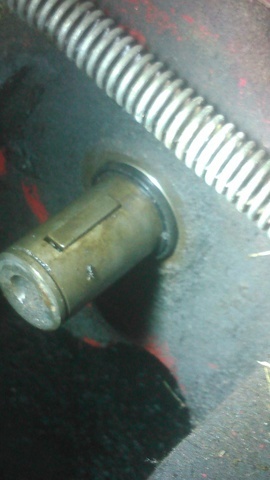

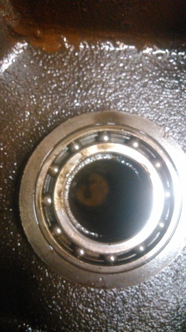

I have a raider 12 with the 5060 trans.  On the right side there is the input shaft, an open bearing and the axle.  Is the middle bearing supposed to be a capped bearing or is there a plug on the end of it?
stevasaurus
It is supposed to be a capped bearing...Wheel Horse #1532 which crosses to KOYO M-16121.  If you go to MotionIndustries.com and type in 00090903 in their search box, you will get a picture and dimensions of the bearing.  :)  You will have to open the transmission to replace it...not a hard job to do.

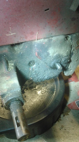

I pulled the brake band off and this is what I find, the bearing is flush and seal is not even pressed into the housing.

Hmmm, do you think it's possible that some excess axiel, end to end movement of the" internals" caused not only the seal to push out, but also the cap of the bearing to also push off?
grine_22
I believe the problem was caused 2 years ago.  I had the tractor in an unheated shed at my old house,  the shifter would not move over winter. Once it thawed out I drained the crankcase and water/brown sludge came out.  Im thinking when the water froze it caused the damage that I'm seeing now.
stevasaurus
What is the history of this horse??  How long have you had it?  It looks like all of the seals are leaking a little.
   I find it hard to believe that a cap bearing would loose it's cap and look like it was never there.  That hole is where your 11/44 toothed gear is (you can see the bottom of the gear), and the brake shaft is the other end.  Those bearings are not going to slide out flush with the casting, unless (maybe, and I say maybe) frozen. That mushroom gear is not able to slide back and forth enough to cause what you have there.  Regardless, I think someone has been in there and did not know what they were doing. when they put it back together.  No way that brake shaft bearing is going to push out a seal against a brake drum that has a "C" clip holding it.  Your thoughts please?  :eusa-think:
BTW...there is absolutely no way that the mushroom gear could move far enough to the right in the transmission housing to even think about touching the bottom end of that "cap" bearing...and your transmission still works.
MalMac
I am leaning to the fact that some one had been in there and had no clue what they were doing. There have been a lot of frozen transmissions and I have seen none do that. Seen them actually bust the case and split but not push out bearings.
grine_22
I don't know the history of it.  I own a scrap yard and the PO brought it in saying the carb or fuel pump was bad.  Tore into it and the rod was snapped.  New rod and it purred like a kitten.  Mowed the grass with it for a month this last year until the rod journal got too warm.  It still ran and drove fine in all gears hi and low.  It may be someone was in there, when I replaced the one axle seal on the same side of the brake band the seal was on backwards, as was the seal behind the brake when I popped the pulley off. Regardless it'll get split at some point this year, but before I do I'd rather have all bearings and seals on hand for the project.  I've got axle seals, as well as seals for break and drive shafts, and I ordered a new cap bearing for the old open one. What other bearings am I in need of? If I'm gonna do it itll be done right the first time.
stevasaurus
Like I said above...all seals and bearings are readily available from like NAPA, Motion Industries the next day.  If you might need a #1533 differential carriage bearing...Mike has good used ones.  He is in central, west end of Ohio.  Might not be far from you.  He also has all the gears for the #5060 10 pinion, limited slip differential and transmission.  At this point, I doubt you will need a lot of that...but some one (and I'm being kind here) was in there.  I would open it as soon as the weather gets nice, if you like that horse...got to be hard to keep oil in the trans with no cap on that bearing.

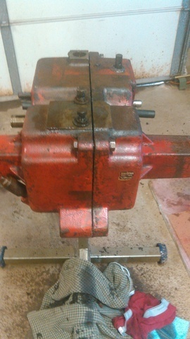

Thanks Bob!! I think I've got everything here or ordered for the trans, 2 axle bearings and seals, brake shaft seal/ bearing, input seal/bearing and mushroom gear capped bearing.  Is that everything or am I missing something?
stevasaurus
You might have more then you need, but, if you are going to replace all the bearings (except the #1533) you also have the bearing on the other end of the cluster gear shaft, a bearing on the other end of the spline shaft, and another cap bearing for the other end of the mushroom gear.  I would wait until you open it first.  You can get any of those bearings in a day.  :)

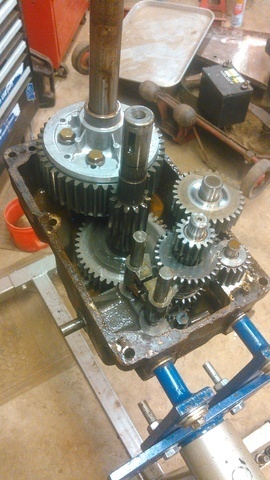

Question for the experienced minds, on the 1533 bearing should the casting be visible inside the center of the bearing?
stevasaurus
The answer to your question is "yes"...and that bearing appears to be OK.  That is why everyone has a problem trying to get them out...you can't just tap them out from the back.  If they are both good...leave them in place.  :)  Your transmission looks real nice and clean.  :handgestures-thumbupright:  I had to check the manual to verify that the bolts in the differential are in the correct way (with the nuts toward the right hand side of the case)...your is correct for your transmission.  It would seem that you only have to replace some bearings and seals and seat the bearings in enough to accept the seals.

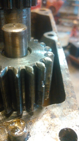

Everything looks to be in good shape for its age, I'll just replace the bearings and put it back together.  Getting the spring and detent balls in seem to be a challenge, struggled with that last night, I've had the gears in and out 3 times now. Only thing that is not right is the small chip in this gear
