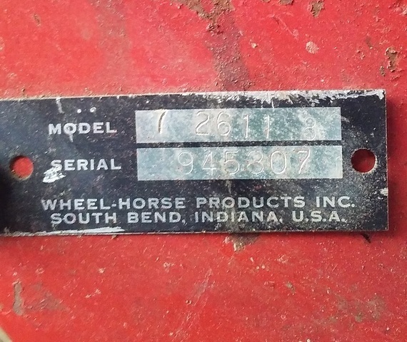

Got some specific info from the seller showing model and serial numbers.
I'm sure someone more knowledgeable than myself can probably identify this by year of manufacturer by these numbers.
56bb121364d3a_WHvacblower2.jpg.1f5a85730
If the model number is 7-2611-8 it is a 1973 model (8-5=3=1973)
The serial number 945307 or 807?
