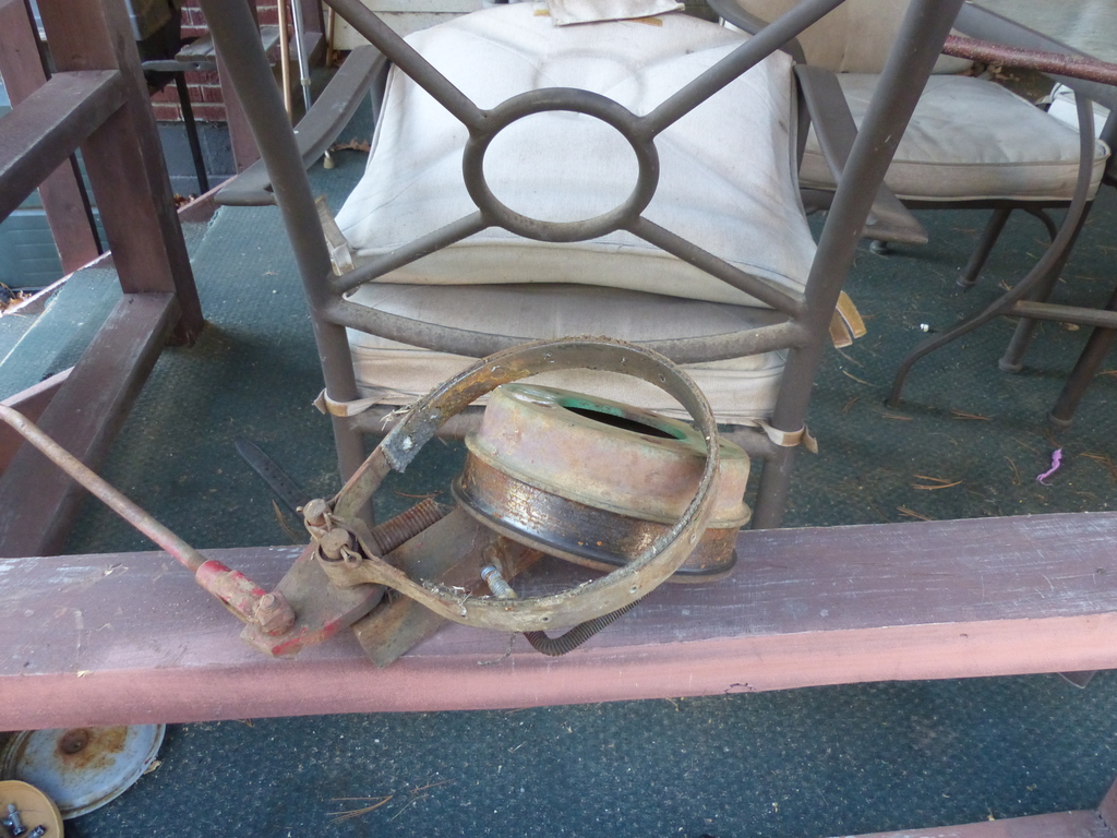

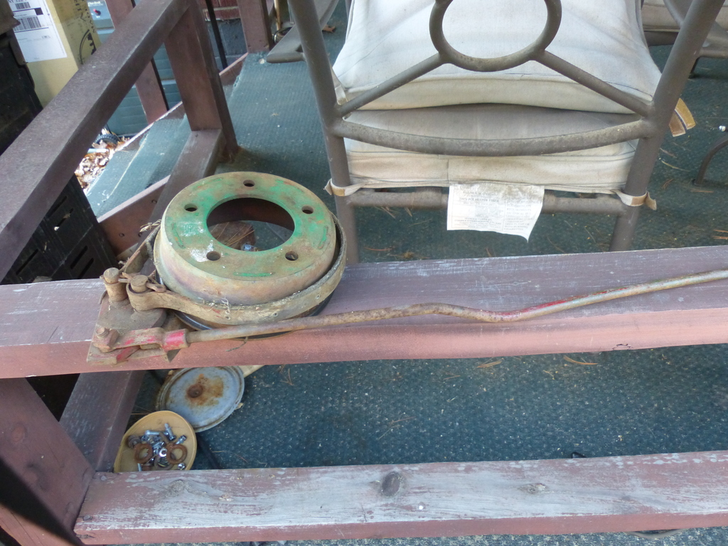

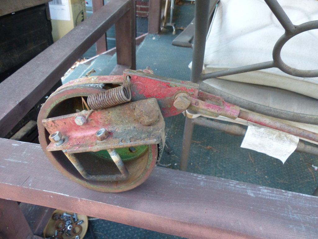

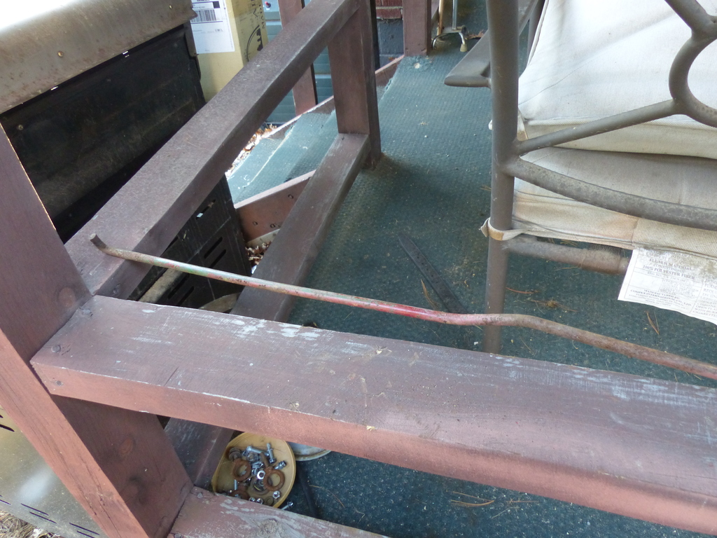

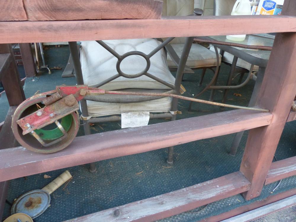

Texas Todd 1,025 #52 Posted January 9, 2017 If you remove one of the rear wheels, could you snap some shots? I would like to see it from the inside as well. Thanks. I may have missed it in the write up, but it took me a while to figure out the brakes were actuated by the foot rests... 1 Share this post Link to post Share on other sites

kasey54 305 #54 Posted January 10, 2017 I have removed them from the unit but yes they were on both wheels. When I bought this tractor it also had 300 plus pounds of lead wheel weights(home made) on the rear of it. My best guess is the original owner used the brakes to help him steer. He may have used them to help him lock a spinning wheel to force the other to turn. Share this post Link to post Share on other sites

kasey54 305 #58 Posted January 16, 2017 Ok Todd as promised , photos 2 Share this post Link to post Share on other sites
Texas Todd 1,025 #59 Posted January 16, 2017 Thank you sir! Pretty cool indeed! Did he just drill a hole in the foot rests to attach the rod? Share this post Link to post Share on other sites
kasey54 305 #60 Posted January 16, 2017 Yes, and removed the set screw to unlock foot rest from their perch so they'd rotate Share this post Link to post Share on other sites
