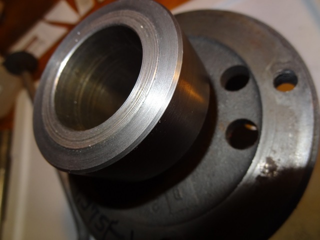

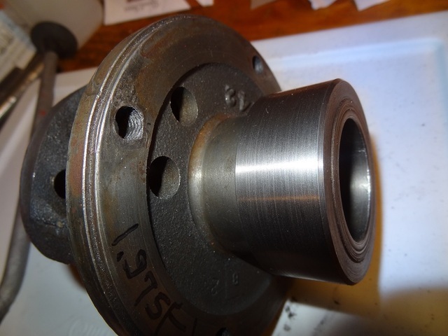

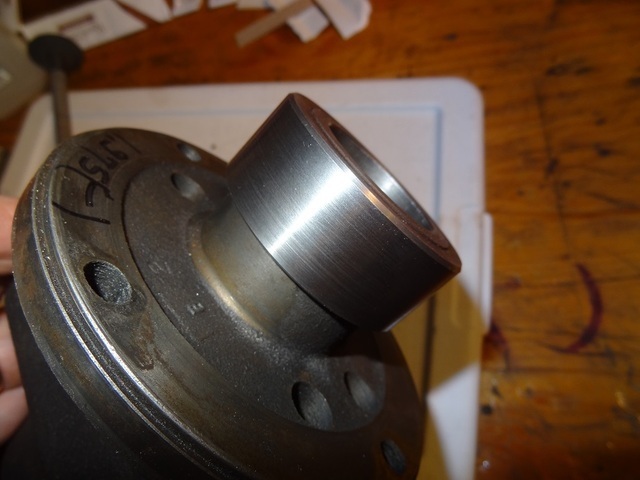

stevasaurus 23,816 #9 Posted February 26, 2016 Just wanted to show what happened to the casting that Eric got. This is copied from the PM we had going...and the pictures following. Thanks Eric. And they did manage to close up the crack. engineguy63 62 Replied: 19 February · Report There thoughts were , as this part is over 50 years old and it may have sat in an oil bath for a while , the cast may have absorbed some oil. Then welding would be iffy at best and it would not help the fact that since it was cracked the bore was expanded. The thought was turn it down clean and shrink a band on which may close the crack up a couple thou, or not, but either way it would not get worse! Anyhow its in the hands of a VERY capable machinist!! Quote Edit Options 3 Share this post Link to post Share on other sites
Racinbob 13,118 #10 Posted February 26, 2016 Wow! That's better than new 1 Share this post Link to post Share on other sites
