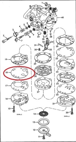

My project, although it's not a tractor, it's still a horse! :) What I'm working on is a 1970 Wheel Horse Safari 309w. It has the Kohler k309-1t with a Tillotson HR-41A carb. The engine runs but, the carb is a bit buggered still. So, I'm looking for as much information about the HR-41A carb as possible, if possible. I believe I have it figured out but, I'm just looking for some confirmation. I have replaced gaskets and diaphragms, and at this moment, I do have a new needle and seat coming. After the initial rebuild, I could not get the carb to pump gas until I removed the, #18. diaphragm (pulse). So, in a nut shell, I'm looking to find out if I'm headed in the right direction with this carb.

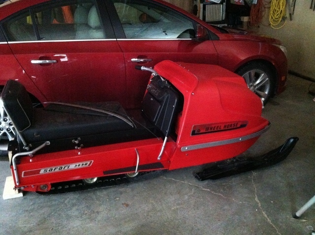

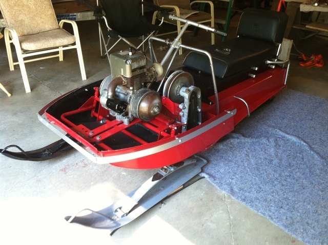

Haha, not a problem! Photos I have! Here's one, although it's a bit farther along now

:WRS:  And your sled looks very nice!

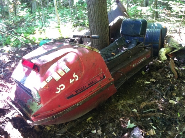

I started with this, a little over a year ago. It's getting there, and thanks for the welcomes!! :)

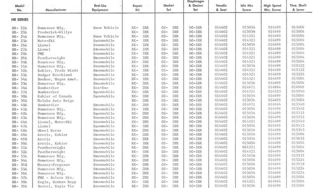

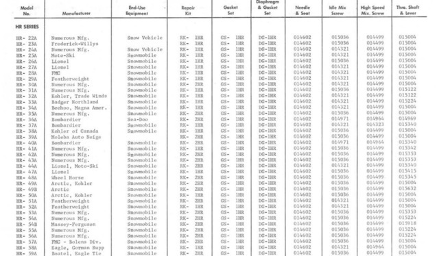

Also, including some info that I'd never seen before that I found. Could be useful!
It'll probably be a few days but,  I'll be back with a status update, thanks! :)

Apologies for not getting back here sooner but, I was on a mission, and the sled is now running! Earlier in this post I had mentioned I removed the #18 diaphragm and got it to pump gas. Well, that #18 does belong in there and has been put back in. I was having a flooding issue so, with putting that diaphragm back in along with a new nozzle check valve seems to have fixed it. The pop-off is about 8 and holding about 6, which is what the carb was popping at when I first checked it before the rebuild. Some things may need some adjustment. I do have a page on FB if anyone wants to see it running just search out, Wheel Horse Safari 309w Project.
