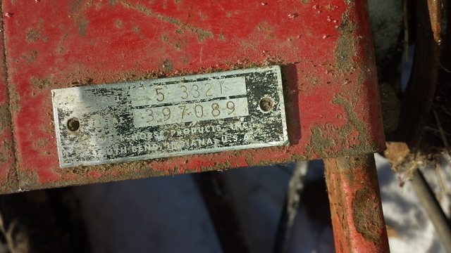

I have a snowblower that has a bad bearing inside the auger on the chain side. Took it apart, and now I can't find a bearing like the one I need! One thing I need to know is if these parts are metric or American? If it is American, it is a 3/4" inside diameter, 1 5/8" outside diameter, 7/16" width. Anybody have a place they get them? Near Rochester, MN. It is a model 53321 snowblower I think as the model # plate is really scratched up.
This is a snowthrower with a mower deck ID plate - model 5-3321 - 32" RD deck for a 1968 Lawn Ranger.
The snowthrower for the 1968 Lawn Ranger was model 6-3211.
Wonder how that happened?

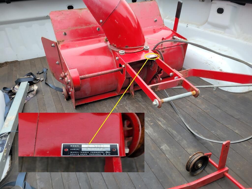

      I am looking for any and all snowthrowers that will work on my GT2500. I am trying to find one off FB marketplace but no one ever really posts the model number. Usually just the length. So I look for 42'' throwers but I don't know what will fit. A local seller has this for sale:
      He says its 42 but unaware the model, the Wheelhorse logo looks to be from the late 60's/early 70's? It looks like the below thrower:
      My question is if that thrower year/model will fit the GT2500. It looks pretty dang simple but I'm not sure. Someone mentioned something about the right size "Quick-hitch" in another post.
