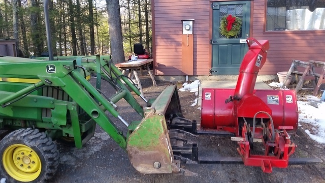

Xearl
Yes . That's it .
Xearl
Thank you WNYPCRepair.   I see they have chain at Tractor Supply .  Sprocket is in the mail  .
WNYPCRepair
3 hours ago, Xearl said:
Yes . That's it .
Wish I had one of those to lift mine. :)
