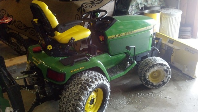

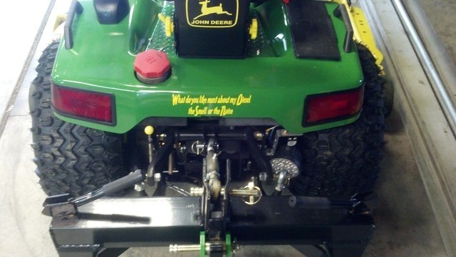

RedRanger
10 minutes ago, WHX6 said:
Thats odd Brian ...I read somewhere here the test is to chain up to something green & yellow and see if you can drag it around....:confusion-shrug:
I'll take that bet.  Hydro to Hydro.

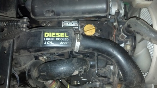

WHX??
No fair...thats a diesel!!!:hide:

elcamino/wheelhorse
048.thumb.jpg.8f80cee0431a1bfa9f3d1c5973067.thumb.jpg.d1ee0680ce8c47107cfbfe6dad104.thumb.jpg.95017476c6bd42f6e0591f8f51
I think you need a 4 wheel alignment , your tires are out of whack.

RedRanger
Makes for fun doughnuts!  :auto-swerve:
