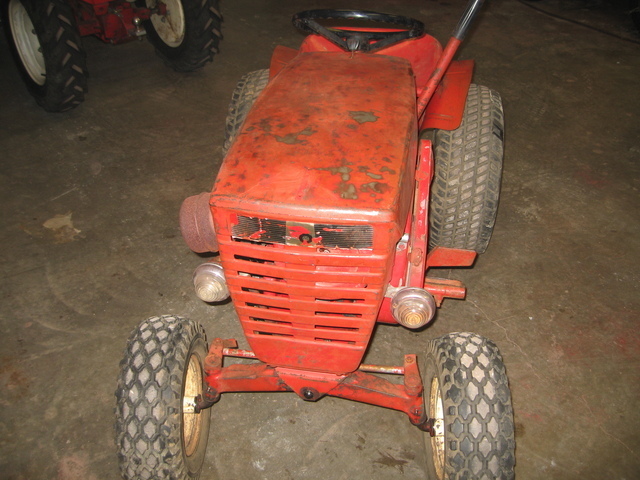

Did some searching and could not find my answer so I will ask. What switch is used for HL 5 headlights and where does it mount on a wedge hood? I have a set  on my 1045 I need to wire up and I want to make sure I have the correct switch and mounting location. Pictures please if you have what I am looking for.
                      Thanks Tom

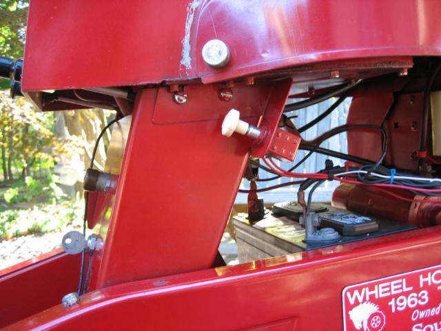

Yes I have them, I was not sure if the switch mounted differently on a wedge hood. Now I see two holes on the side of the hood stand that would be used to mount the switch. Now I need to find the mounting bracket or make one.

In what year/model did WH change the switch bracket?
The earlier bracket is a simple "Z" bracket carried over from the 1961-1962 HL-22 and the later kit has a newer more complicated better looking stamped bracket for the HL-5.
The manuals for each kit reflect the HL-22 "Z" bracket in the drawings for both the HL-22 and the HL-5.
So the early HL-5 kit still used the earlier HL-22 switch bracket.
Was there a specific year or model the simple Z bracket went away?  I've seen 63 and 64 models with the simple Z bracket.
