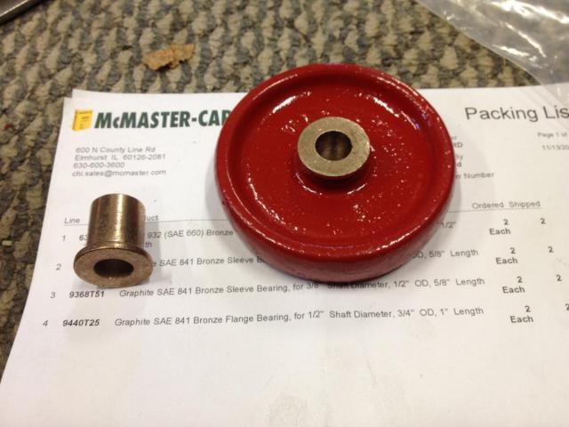

Mr. 856 170 #1 Posted January 15, 2016 Anyone have the part # for the steel wheel bushing on a single stage blower? Wheel has 1987 and 2 and B stamped into the side. My bushing is broken and I like to order a new one. Are there supposed to be two wheels? Mine only had one. Not sure what model I have. Mounts to a 856. Any help? Share this post Link to post Share on other sites
gwest_ca-(File Mod) 12,478 #2 Posted January 15, 2016 Here is the 1966 snowthrower sold at the time for the 856. Bushing is shown in the ipl. Garry 1 Share this post Link to post Share on other sites
Martin 2,134 #3 Posted January 15, 2016 (edited) Alternative to OEM bushing. They work well. http://www.wheelhorseforum.com/topic/37692-blower-rebuild/?do=findComment&comment=484959 9440T25 Graphite SAE 841 Bronze Flange Bearing for 1/2" Shaft Diameter, 3/4" OD 1" Length. (bottom line on McMaster Packing List) Edited January 15, 2016 by Martin 1 Share this post Link to post Share on other sites
Mr. 856 170 #4 Posted January 15, 2016 Thank you fellas!! Share this post Link to post Share on other sites
