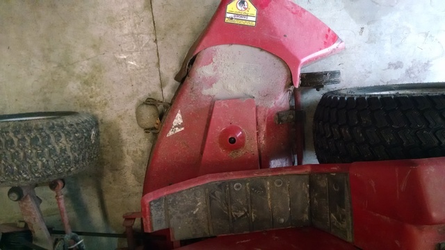

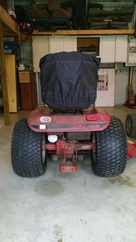

I don't get on here too often but a quick update, I finally replaced the rear tires on my 520. I went with the 24x12x12's. They float great on soft soil and work just fine with the 48" deck. Thanks Martin for the help and advice!! I will soon do the fronts and eventually get to restoring it. Sorry it is absolutely filthy in the pictures....
