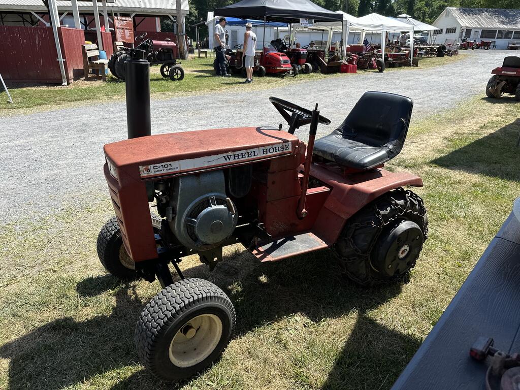

Picked up a C-101 this morning!

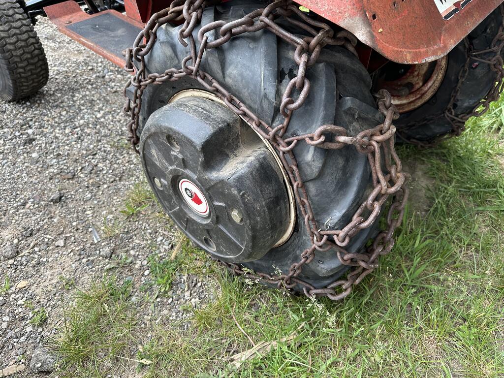

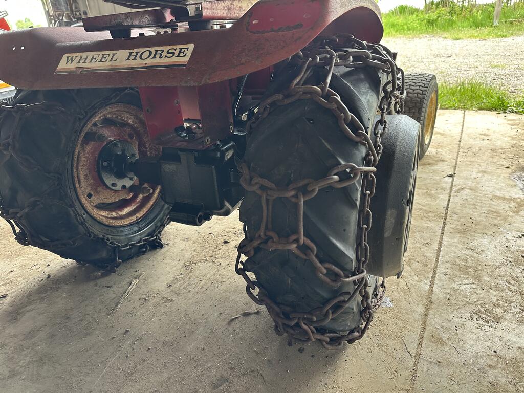

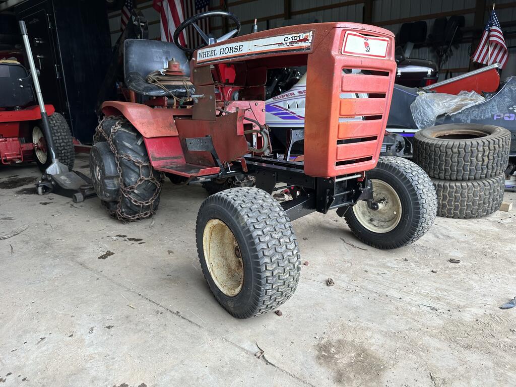

I did some switcherooing today.  These Deestone 23-8.50-12’s are the first tires I ever bought for a :wh:.  They’re also the first I ever fluid filled.  I don’t know the source of these chains, but they are monsters!  They happened to be the only tires that the chains fit.  Well, it was meant to be.
I pressure washed them, mounted them up (they are super heavy!), then added these fairly wide :wh: plastic/concrete weights.
What a difference in the way it pushes!  There is still no engine.  @wallfish and I plan to remedy that once we get settled in at the big show!

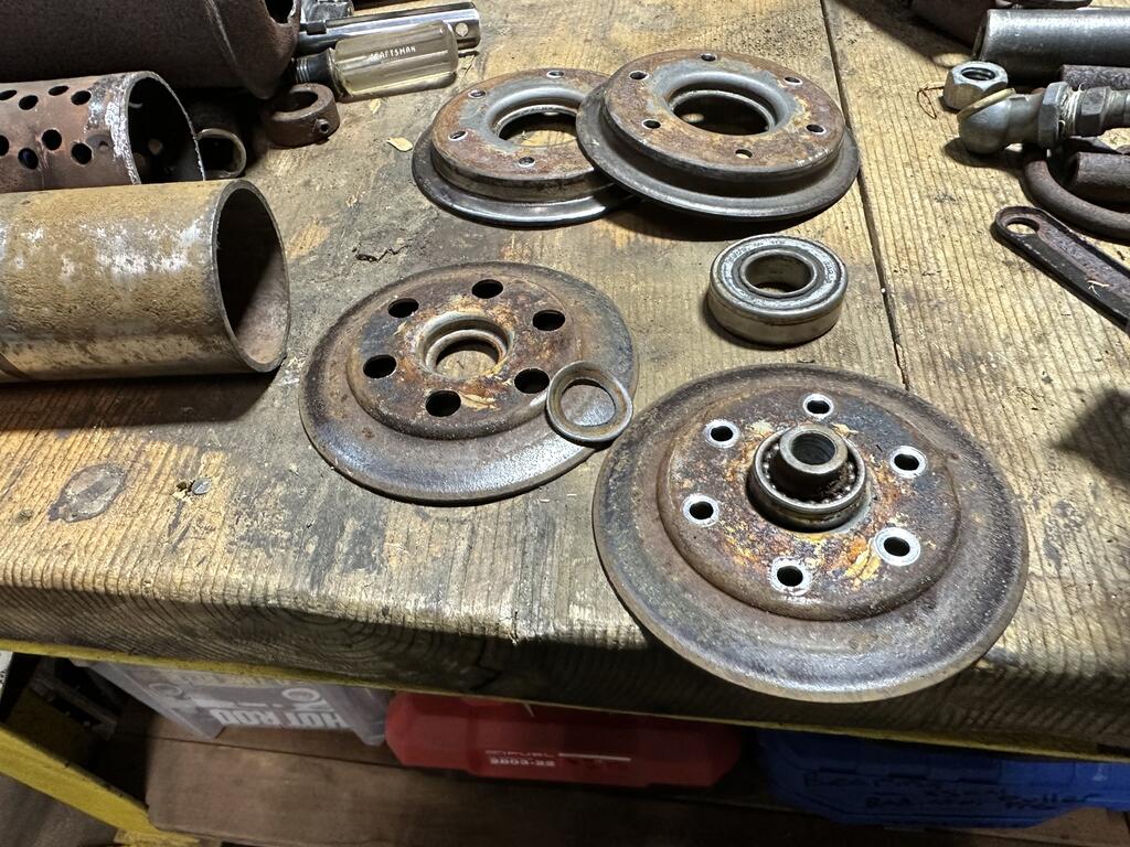

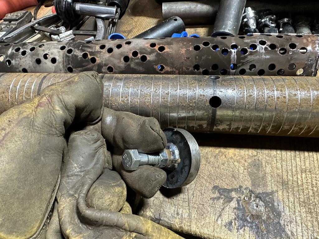

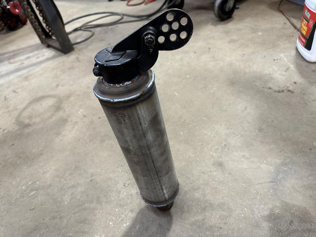

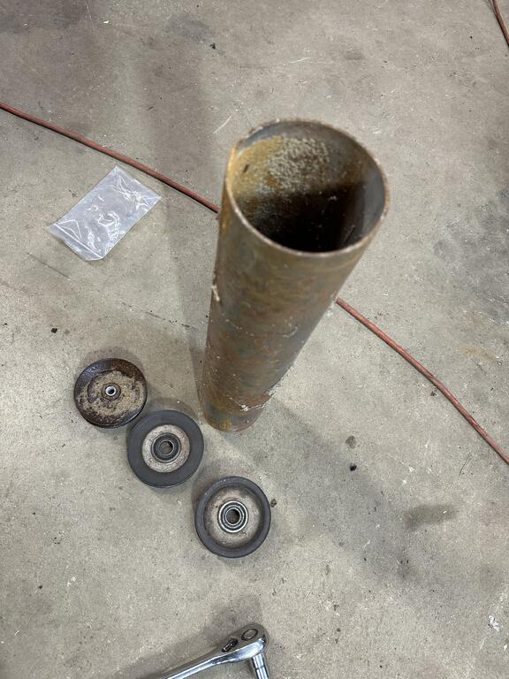

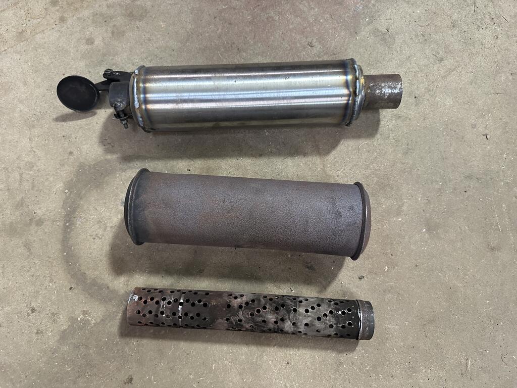

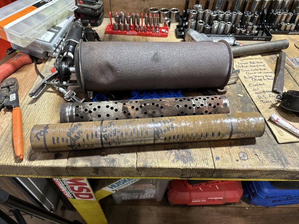

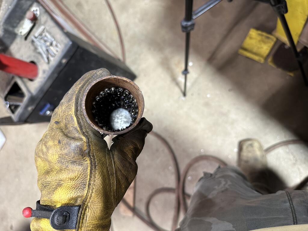

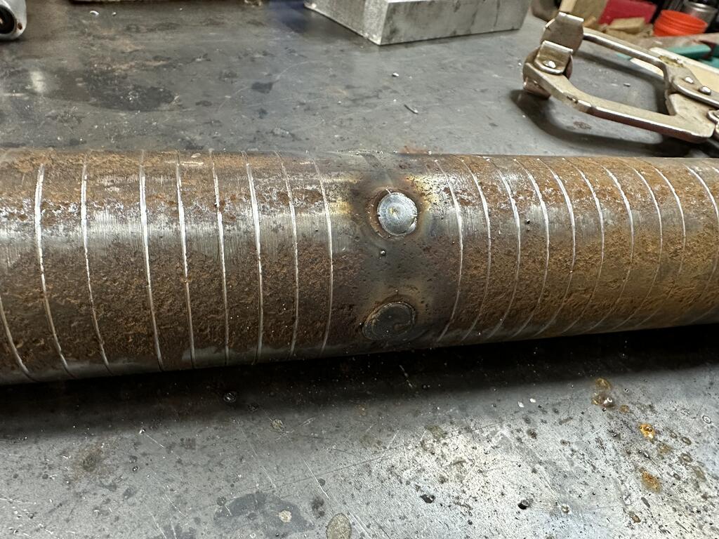

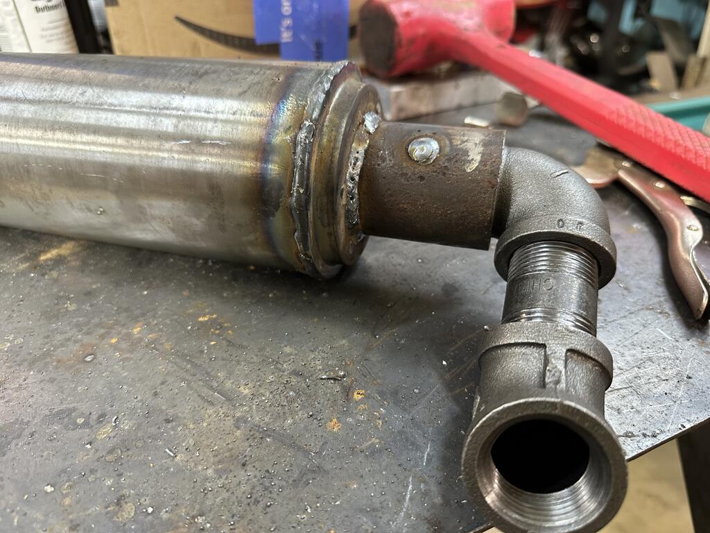

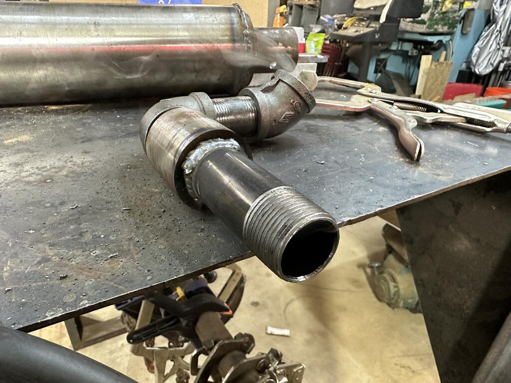

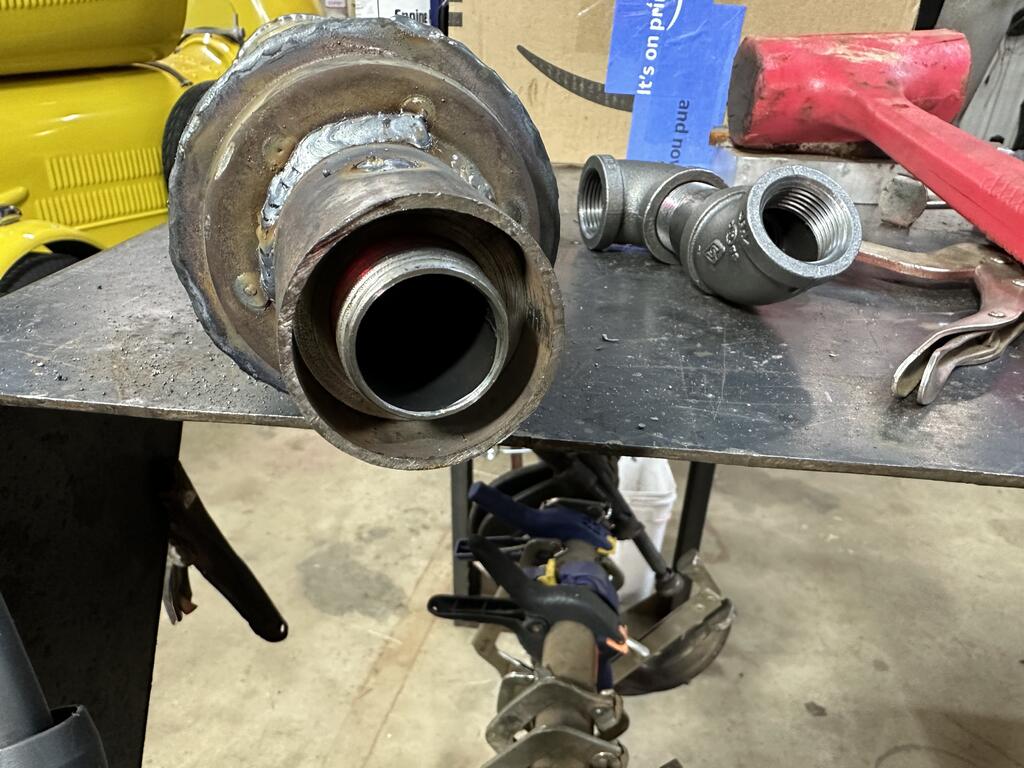

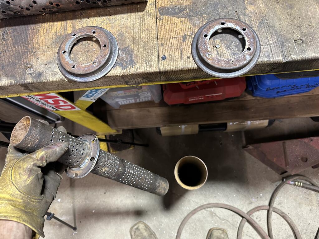

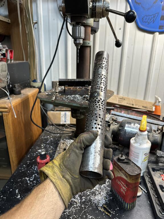

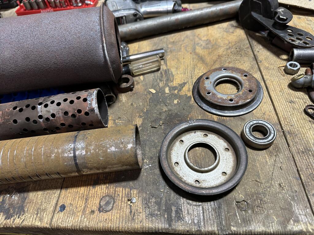

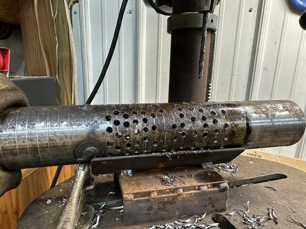

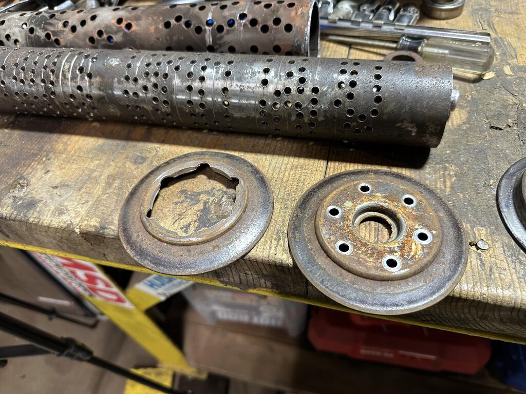

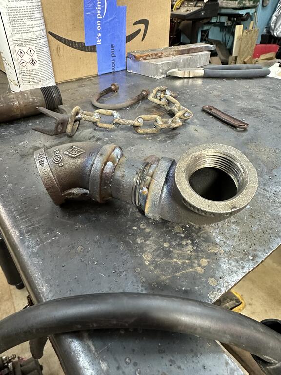

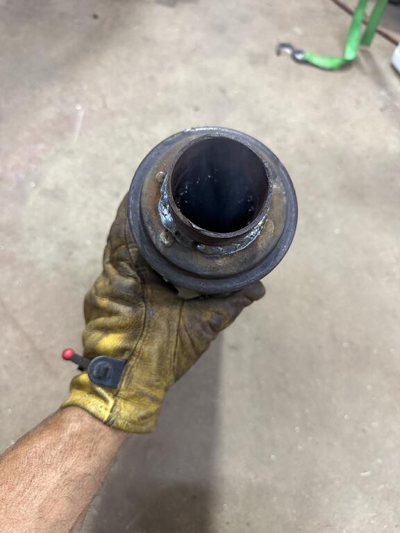

I drilled the spot welds out of some old pulleys and popped them apart.  One is a mule drive pulley, the other a clutch tensioner from a Raider 10.  Doing some math, I decided 14 3/16” holes in each row would be adequate to meet the throughput of this 2” stack, more than enough for a 1” black pipe.  The second chamber baffle allows half the area of the pipe to flow through the outside, and the rest is directed back inside the 2” pipe.  I’m hoping for a mellow tone, not too loud, and not too wimpy.  I’ll machine a block sleeve at the bottom end to well center a 1” x 6” pipe to run the exhaust up towards the welded center baffle and weld it all together before it’s complete and ready for some high temp paint.  I’ll probably weigh the tink slapper down so it is more active than normal.
I won’t hear this make noise, until the Big Show.  That’s when this tractor will get its destined engine.  I need to finish the bottom end of it, to screw into a 1” black elbow.  I have a mock up engine here and will build a stack brace, then will paint it, and pack it away for the show!
Hi temp paint is drying!

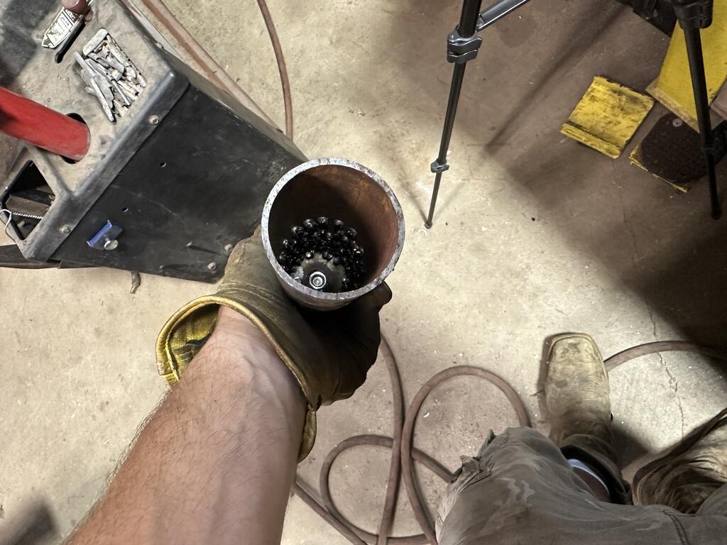

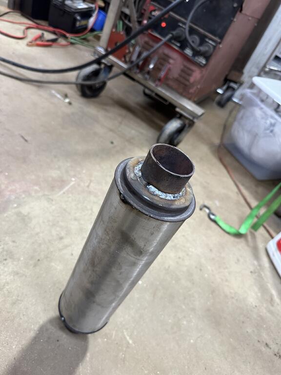

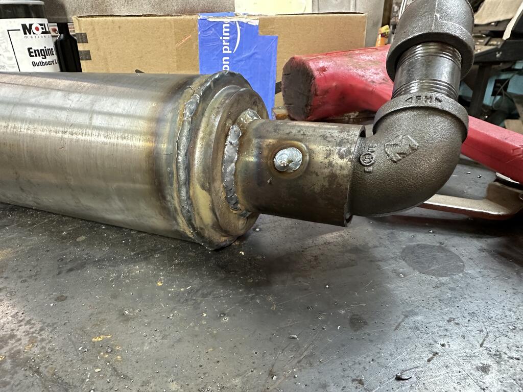

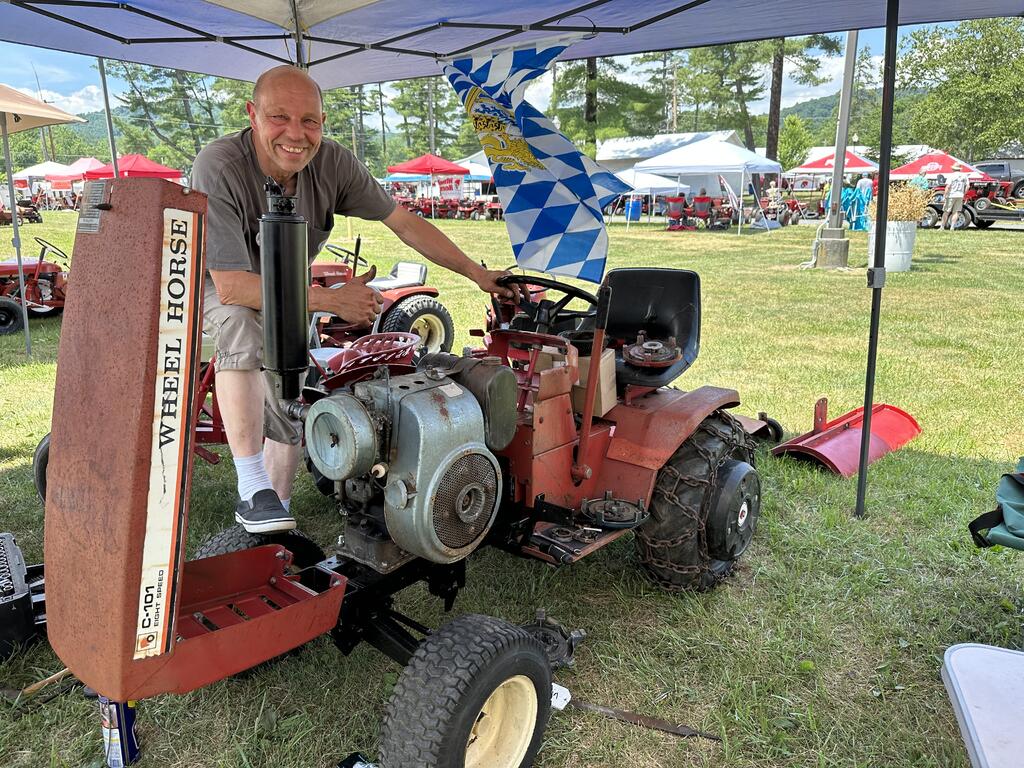

I used a broken rod engine for a mock up piece and built the rest of the exhaust.  It should work out great!
  • Excellent 3

Very impressed with the innovative chain support!

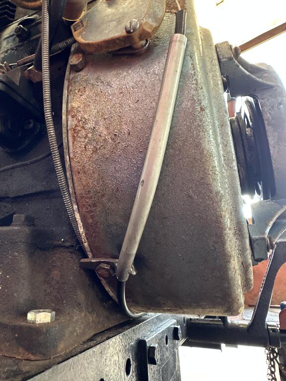

Have yo ever seen those tensegrity tables?  I had that idea in mind, then it transformed into what you see.  My hope, is that it all works on the planned engine at the show!  Once again, there will be not much room for adjustment once it’s all assembled, and I won’t know if it works until we get there!

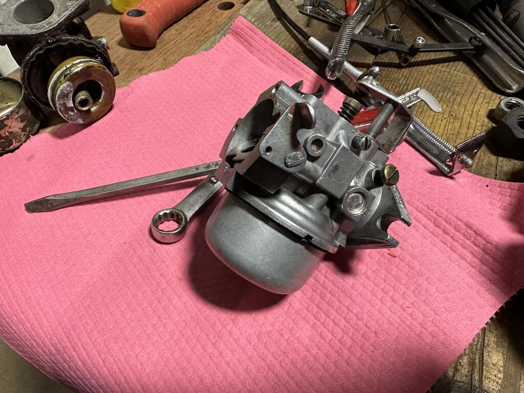

One more piece of the puzzle.  I’ve got this #26 carb all dipped, cleaned and tuned up for the show.
A HUGE thank you is in order, to @wallfish for giving me this engine, and for his and @Tractorhead’s help today getting it running!  A @Pullstart Kohler 12 hp engine!  It runs and sounds amazing!

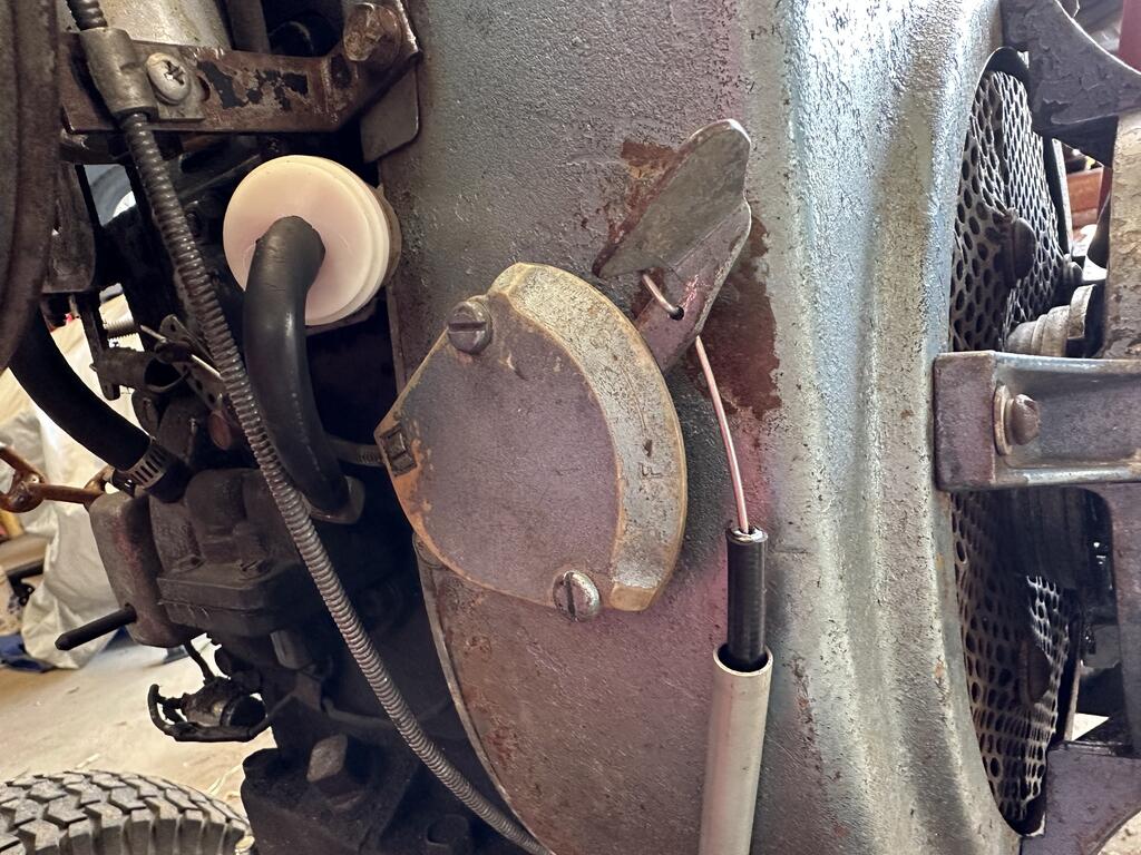

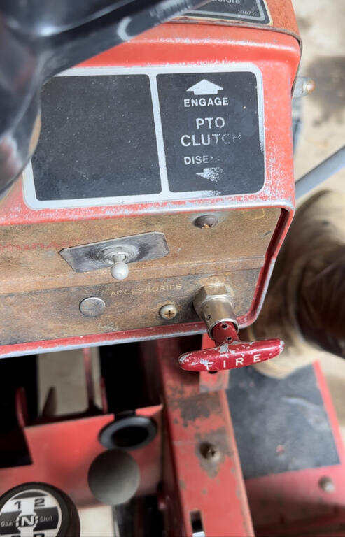

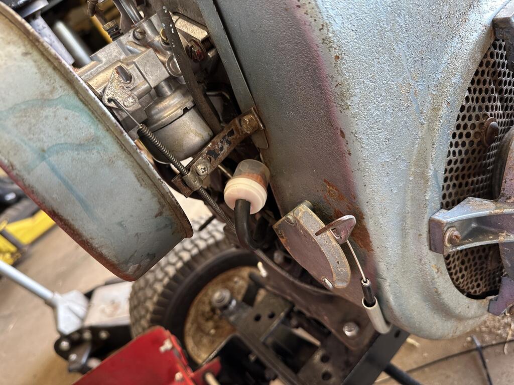

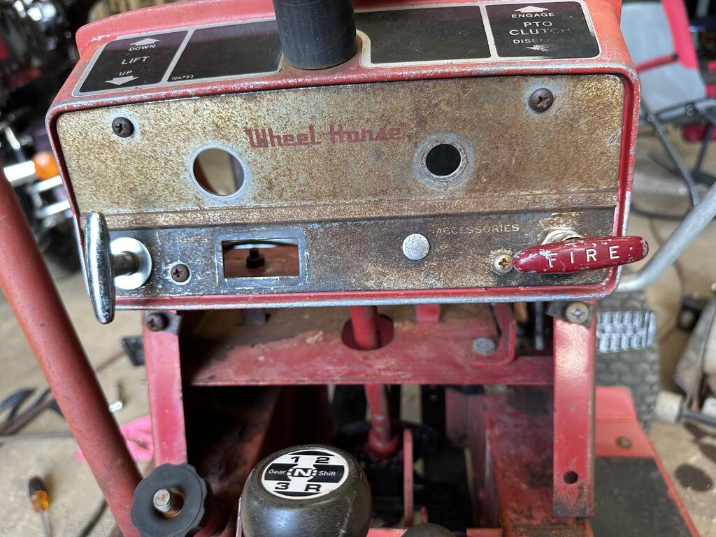

I’ll probably end up sticking a push button in place of the toggle switch, but I have a functioning dash now.  Choke, throttle and kill.  The throttle on the engine shroud was too cool to remove and has a real smooth tight brake on it to keep the throttle set.  I used an old fire suppression cable on the dash and cut it to fit.  It is sleeved using an old Small Block Chevy valve cover tab welded to a piece of 3/8” fuel line.  I also cut the choke cable to fit, so there is no excess slack anywhere on the tractor.  Notice the shift pattern.  Somehow, I ended up with this backerds print.  If you aren’t careful, you might find yourself in the wrong gear but we drive by muscle memory, right?
