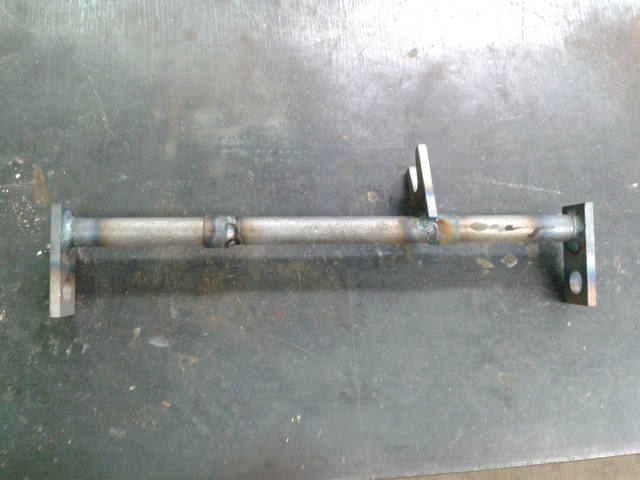

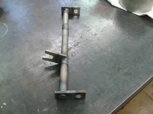

cleat 6,778 #1 Posted December 30, 2015 Most of my deck hitches are badly worn so I decided to make a couple. These are for my 42" and 48" decks. 60" is completely different. They are just tacked together now to check for fitment, I will take them back to work for final welding and painting. I have drawn up the plans, I will scan them and post as well. Cleat 19 Share this post Link to post Share on other sites

WNYPCRepair 1,923 #10 Posted December 31, 2015 What did you use to cut the notches, they are nice and clean 1 Share this post Link to post Share on other sites

cleat 6,778 #13 Posted December 31, 2015 I just used a hand held mini-grinder (5") with a zipcut wheel to make the notch after drilling the 1/2" hole. For the other end of that same plate, I just drilled a 3/4" hole then cut right through the centerline of the hole to make it act like a saddle. All dimensions will be on the plans which will be uploaded soon. No special tools were used to make this, just a drill press, mini-grinder, and a welder. I do all measurements with a vernier caliper but a tape measure would work. Cleat 5 Share this post Link to post Share on other sites
WNYPCRepair 1,923 #14 Posted December 31, 2015 1 hour ago, cleat said: I just used a hand held mini-grinder (5") with a zipcut wheel to make the notch after drilling the 1/2" hole. For the other end of that same plate, I just drilled a 3/4" hole then cut right through the centerline of the hole to make it act like a saddle. All dimensions will be on the plans which will be uploaded soon. No special tools were used to make this, just a drill press, mini-grinder, and a welder. I do all measurements with a vernier caliper but a tape measure would work. Cleat Nice, I would have thought a plasma cutter or band saw they are so precise Share this post Link to post Share on other sites

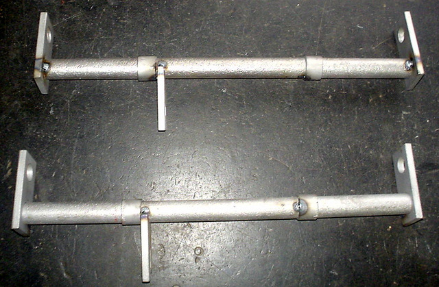

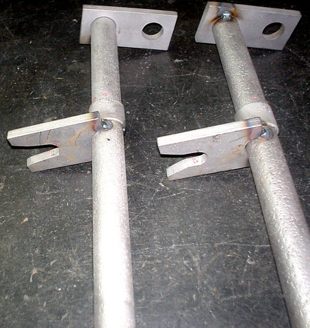

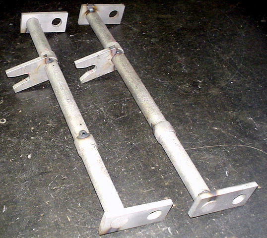

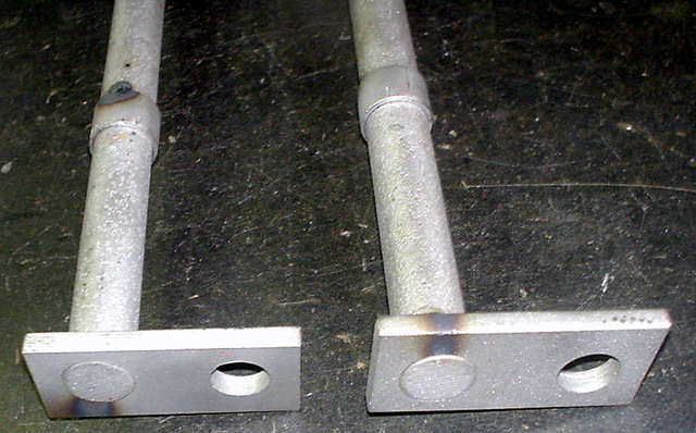

cleat 6,778 #24 Posted January 12, 2016 (edited) Deck hitch is now welded up. Just needs cleanup and paint. Cleat Edited January 12, 2016 by cleat 5 Share this post Link to post Share on other sites
Kurt-NEPA 755 #25 Posted January 14, 2016 Fantastic project. Thanks so much for sharing. One of my 48"SD decks is badly worn, when the 3/4" rod gets that bad, it will fall out of the tach-o-matic hitch. With your drawings, I now have a Spring project. Kurt Share this post Link to post Share on other sites
