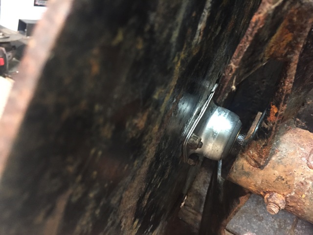

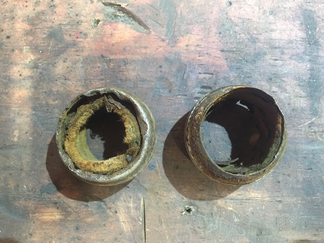

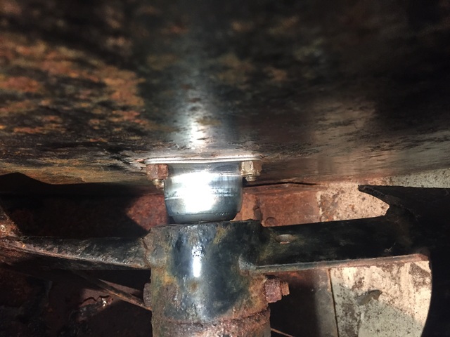

WNYPCRepair 1,924 #8 Posted December 27, 2015 I bet I could have gotten a couple more hours out of these. Share this post Link to post Share on other sites
Digger 66 3,530 #9 Posted December 27, 2015 W O W ! 1 Share this post Link to post Share on other sites

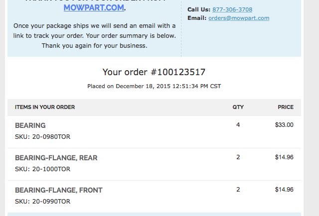

WNYPCRepair 1,924 #10 Posted December 27, 2015 I replaced the first bearing, and thought "I should have ordered the flanges, these are kind of rusty. I wonder why I didn't?" Replaced the second, reached into the box and pulled out a set of flanges. Yep, I ordered them. So I did the first one again and replaced both sets of flanges too. 1 Share this post Link to post Share on other sites
Digger 66 3,530 #11 Posted December 27, 2015 (edited) Where'd ya get 'em ? I have to get my walk-behind apart this summer & go through it . Edited December 27, 2015 by Digger 66 Share this post Link to post Share on other sites
WNYPCRepair 1,924 #12 Posted December 27, 2015 9 minutes ago, Digger 66 said: Where'd ya get 'em ? I have to get my walk-behind apart this summer & go through it . Share this post Link to post Share on other sites
Digger 66 3,530 #13 Posted December 27, 2015 Ahhh Ha . Thought maybe you went to Fox . Share this post Link to post Share on other sites
