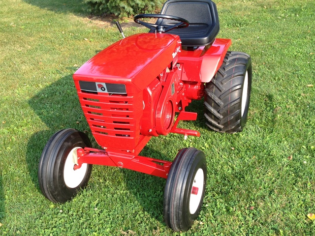

 Merry Christmas to you all! My question is the specs call for a 16x5.5-8 tire size..I would like to put the three rib tires on but only see it in a 6 or 6.5 sizes. Any thoughts? I see photos of a lot of nice machines with these types of tires, just need to know what size I should buy. I am very sure my wheels are bone stock. The new paint did turn out nice though. Thanks for the help.
bob's toy
One thing about a moment ago, my old turf tires are 16x6.5-8. Should have seen this before I asked my question. Any thoughts on which ribbed tire I should use?
Martin
You could use these.....
Deestone D401, I have seen these on the later wider wheel as well, but i think they look just right on the earlier narrow wheels.
Search 'Deestone D401' on eBay they run about $70 a pair (inc. tubes and shipping). Ive had a good experience through eBay seller: k-morrow.
bob's toy
Thank you, I agree, the tires do look great. I was confused by the rim size, not seeing any tires for the narrow rim...then, when I saw the actual size on the old turf tires a light went off in my mind and sure enough, with help from my fellow WH friends, I will now order some tires. Thank you both for your help.  Martin, your tractor looks GREAT. Being raised on the rice farms here in Katy area, I knew I had to have the REAL tractor look. Thanks again for your support.
