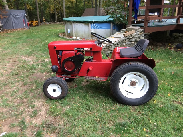

tom h.hill 10 #1 Posted December 15, 2015 i have a 1054 that runs pretty good . the fuel pump isnt stock.its set up were i tapped and threaded in a pipe fitting in the block were the stock one would go.generator starter wascleaned up an new bearings .put a new solinode and voltage regulator.redid the wiring.that you might have to take a look at.got the origanal rear 15" wheels.sandblasted both front an back an new paint.new snow tires on the rears.made a stainless grill for her.moumted new bigger headlights.so anyways i was driving it threw my back yard about 6 months ago and it just stopped moving.put it into reverse nothin.so i guess theres a pin inside that let go.i dont have the time to take it apart so i wanna sell her.if anyone is interested let me know Share this post Link to post Share on other sites

Pullstart 63,201 #3 Posted December 16, 2015 Not to lead you away from what you want to do, but did you check small things like the belt for wear or a cut, any woodruff keys in the drive pulleys and on the hubs? I had a key come out of a loose hub while mowing one day, that was quite a mystery to figure out with no noise... just a swift nothing while in gear, moving around a corner. good luck! 1 Share this post Link to post Share on other sites
tbarnhart 240 #4 Posted December 16, 2015 Yea, check the rear wheel hubs. I can see from your picture that the one on the left seems to have come loose and moved on the axle. Good chance a hub and key will fix that one. 4 Share this post Link to post Share on other sites
