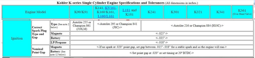

pointman8 0 #8 Posted July 31 Hey all is there a list some place that shows Plugs for all models ? I'm new and don't want to kick the dead horse for my 1978 C101 with K241AS-46766D thanks Share this post Link to post Share on other sites
squonk 41,220 #9 Posted July 31 Autolite 216 for Big block Kohlers. Share this post Link to post Share on other sites
953 nut 55,523 #10 Posted August 1 16 hours ago, pointman8 said: is there a list some place that shows Plugs for all models 1 Share this post Link to post Share on other sites

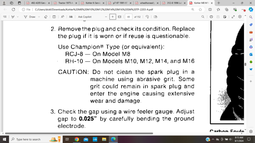

Mike'sHorseBarn 3,007 #11 Posted August 1 Hmm I've never seen the different gaps for different ignition types before. I've always set my plug gaps at .025. Share this post Link to post Share on other sites
953 nut 55,523 #12 Posted August 1 4 minutes ago, Mike'sHorseBarn said: Hmm I've never seen the different gaps for different ignition types before. I've always set my plug gaps at .025. That is true for all magnums as shown in the service manual for them. Share this post Link to post Share on other sites
sqrlgtr 552 #13 Posted August 1 I'm running NGK B-6L in the k341 and NGK b-4 in the k181's but have had good luck out of the Autolites also. I started running the NGK's in old VW bugs and thought I would try them in the Kohlers and never looked back. I would prefer either of these over the Champion's, but everybody has their favorites. I got a hold of some bad Champions way back and that's what soured me on them but lots and I mean lots of people swear by them... .025 on the K181 and .035 on the K341 and .020 on the points but that may vary only your engine knows where it will run the best. .020 will get you close enough and may work great for you. 1 Share this post Link to post Share on other sites
