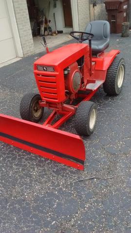

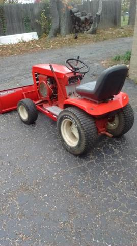

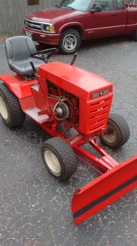

Ken B 3,165 #38 Posted December 9, 2015 (edited) I painted this little bundle of joy almost 3 yrs. ago with Rustoleum Regal Red and it is holding up very well. I did all the body work and prep just as I would have if I were using automotive paints. I spent 3 solid days on the body work alone. It wasn't meant to be any type of show tractor, just something to beat around on and that is exactly what I do with it... It has been to 3 Big Shows and it always gets run hard in the Saturday night Dust Bowl. Now, if i'm going to do a "show" tractor I'm with Bob Maynard, Its going to get only automotive paints, ESPECIALLY if its a more difficult tractor to take apart and put back together. If I'm going to do a 520 or similar tractor to be a "show" queen I won't waste my time with spray bomb paints because this type tractor is much more involved in taking apart and reassembling and you are much more likely to scratch it putting it back together. If I'm going to do that much work it may as well be done with the good stuff, JMO. The Suburban does get waxed with carnanuba wax to help keep it shiny. I don't clear coat any tractor that I spray bomb with Rustoleum as I have found the results to be too unpredictable. Even following all the recommendations of the manufacturer sometimes the paint wrinkles up and then you are nothing but pissed off because the paint WAS perfect and now you are at square one.. So, before you add that clear coat I gotta ask.. Are you feelin lucky? Edited December 9, 2015 by Ken B 7 Share this post Link to post Share on other sites
car 24 #39 Posted December 9, 2015 Did you wet sand any of these? Share this post Link to post Share on other sites
Ken B 3,165 #40 Posted December 10, 2015 (edited) 28 minutes ago, car said: Did you wet sand any of these? I'm not sure if you are asking me but if so then no I didn't wet sand. Before I paint a tractor with Rustoleum I make absolutely sure that there is no dust present. When I paint I usually hold a light in one hand as I'm painting because it helps me to see what I call dry spots or uneven coverage.. you only have so much control out of a spray nozzle. When I'm putting on the final coat I make sure its a good wet one. Ya gotta know when to say when before you cause a run but that only comes from experience i guess. Rustoeum paint does take some time before you can handle it so you have to paint where you know it won't get crap in it or some clown comes along and decides to touch it. If I do have to wet sand a tractor that I used Rustoeum on I wait at least a month and that long wait is mostly because buffing will take place soon after wet sanding and Rustoeum burns real easy... Edited December 10, 2015 by Ken B 2 Share this post Link to post Share on other sites
