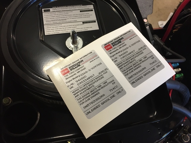

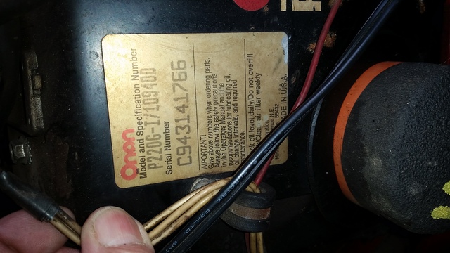

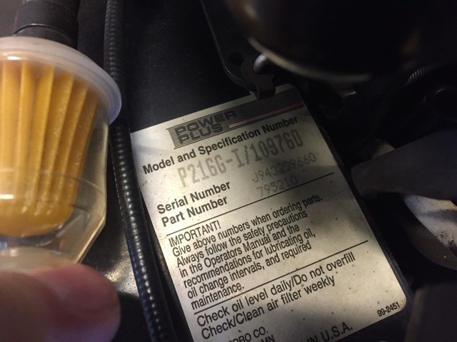

Your engine is a P220 and not a B48M. Both are different engines. The P220 as Boomer states above used a taper seat, long reach plug, either a RS14YC or RS17YX. The early/late engine cut off could be determined by the spec number above. P220G-I is your engine model number, 10940D is the spec number with the last letter being the key here. Im not 100% on what letter designated the change over from one plug to the other, but the D spec is an early engine compared to the G. I have 2  WH 416s, a hydro and an 8 speed.
Here is the decal from my 1995 416H. Spec on this engine is 10976D.
My 8 speed is once again a 1995 but made later than the 416H, the WH serials are only 200 or so apart. This is a reproduction spec decal from that 1995 416 -8. All the numbers are exactly how the original decal was. The spec on this one is 10976G. So it looks like WH changed from D to G spec engines in 1995. Note the D spec decal has a similar look to yours (without the Toro Power Plus header) and the lower one had a newer look.
Edited by Martin
  • Like 1
JackC
Reproduction ONAN spec decal? Where can we get those? Vinylguy?
Martin
yep......
