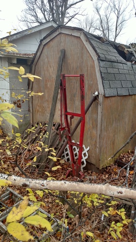

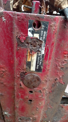

RedRanger 1,470 #1 Posted November 20, 2015 What models of tractor does this fit?Blade is buried in years of leaves and branches/mulch.I'm guessing it hasn't moved in a decade or more.Serial 50168 Share this post Link to post Share on other sites
Ed Kennell 47,054 #2 Posted November 20, 2015 I believe that should fit any C, 300, 400, or 500. 1 Share this post Link to post Share on other sites
RedRanger 1,470 #3 Posted November 20, 2015 Thank you.I was going to hit the owner up and buy it, but then I'd have to buy a tractor to fit it. 1 Share this post Link to post Share on other sites
Ed Kennell 47,054 #4 Posted November 20, 2015 Sounds like a good reason to add-a-. 2 Share this post Link to post Share on other sites
gwest_ca-(File Mod) 12,472 #5 Posted November 20, 2015 If it is a 48" width it may be a 1988 model 06-48BC01 which was produced 1984-1989.I have serial 50002 with a build date of July 11, 1988This one is 50168Have seen 51721 with a build date of September 24, 1988Garry 1 Share this post Link to post Share on other sites
RedRanger 1,470 #6 Posted November 20, 2015 I've got 3 since last December already and looking at another on Monday, along with my yellow and green one.The wife just doesn't understand and is beginning to give me grief already.(She doesn't know about the one next Monday) If it is a 48" width it may be a 1988 model 06-48BC01 which was produced 1984-1989.I have serial 50002 with a build date of July 11, 1988This one is 50168Have seen 51721 with a build date of September 24, 1988Garry If it fit my short frame or a round hood, I'd grab it up as a toy. Just don't have any plans for that new of a horse right now. I know this person also has a 4xx series that is in really nice shape, but she's getting older and is paying for lawn and snow service for a few years now. I kind of wonder what other horse stuff she has in her shed..if any. Guess I need to go ask. Share this post Link to post Share on other sites
Tankman 3,528 #7 Posted November 20, 2015 I believe that should fit any C, 300, 400, or 500. It would except a 500 with the forward swept axle. You would need a plow frame extension kit or, like I did, weld extensions to the frame. Share this post Link to post Share on other sites
wallfish 20,532 #8 Posted November 20, 2015 It will fit a short frame tractor by moving the bar which attaches it to the tractor but not a little mid engine round hood Share this post Link to post Share on other sites

RedRanger 1,470 #10 Posted November 21, 2015 It will fit a short frame tractor by moving the bar which attaches it to the tractor but not a little mid engine round hood So it would fit my 867? Does the bar have to be cut out and welded or is it adjustable? Share this post Link to post Share on other sites
