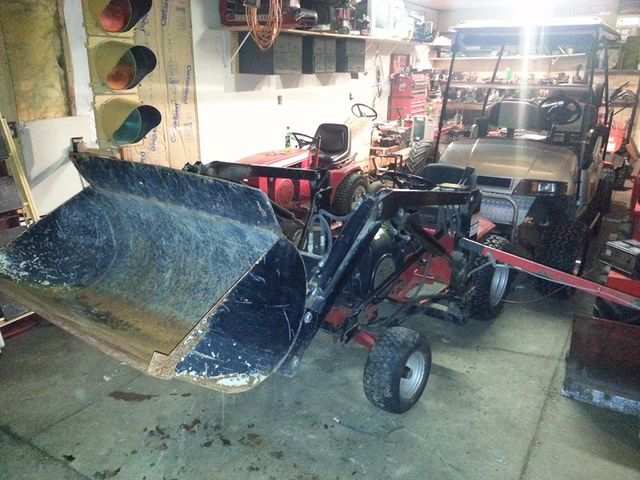

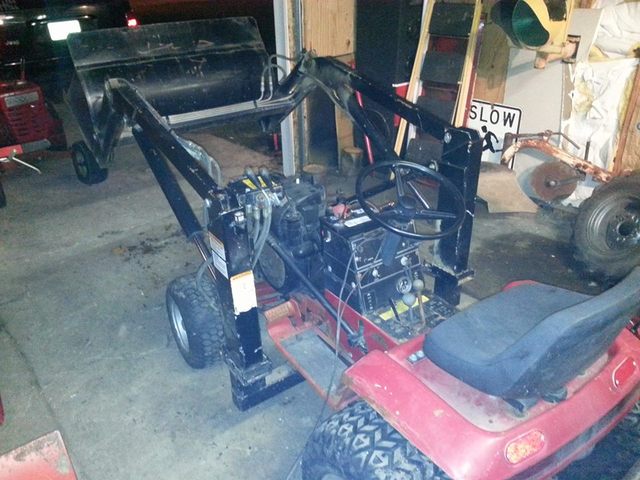

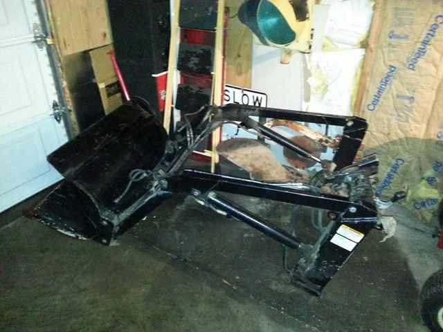

About a year ago I bought a C-121 auto with the intention of using it as my go-to mower. Shortly thereafter I got a great deal on a low hour 314-8. It ran perfect and had several attachments - it became my new go-to mower. So, I decided to repurpose the 121 to be a front end loader. After purchasing the build plans from P.F Engineering (which are excellent), I realized I couldn’t build it for less than $2k in material. I decided to look for a used one and found a Thompson TC10 local to me, mounted on an “end of life” 1077, for $1,000. The loader swap itself was pretty straight forward. The only modifications needed were drilling a couple of mounting holes in the tractor frame, grinding away a little of the loader top frame so the hood opened/closed and welding in a new hydraulic pump mount. I have a few things to button up still and the bucket itself needs attention but it’s fully functional. I also bought a pair of clamp-on pallet forks.
I also did a “refresh” of the 121. The total project cost is shown below. Roughly $2,300, with just the FEL itself being around $1,300.

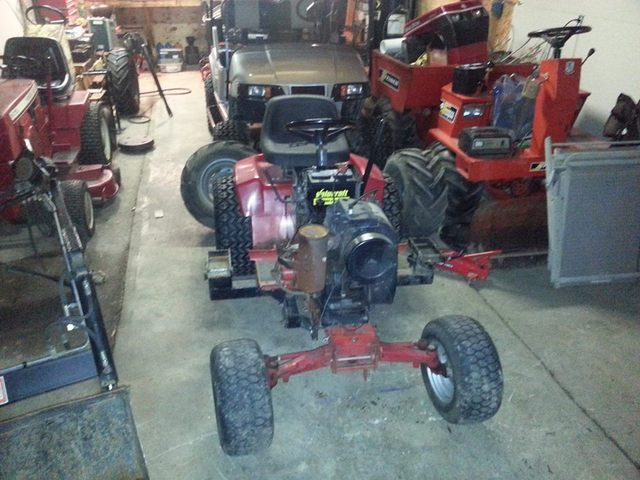

Howdy. I recently purchased a non-running 1277 with a Johnson 10 Loader from a fellow RS member. I bought it for the loader - to put on my C121, then I figured I’d just get rid of the 1277. Now I’m wondering if I should try and get it running and leave the loader on it. The motor turns by hand. I’ve tinkered with motors but never much more than the basics. The battery that’s in it is labeled 2017, so it probably was in use then. What’s the easiest option, swap the loader or try and get it running? What would you do? Thanks!
