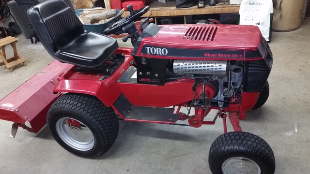

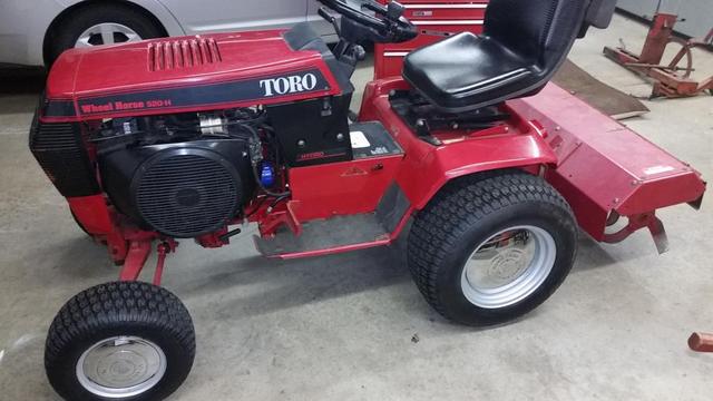

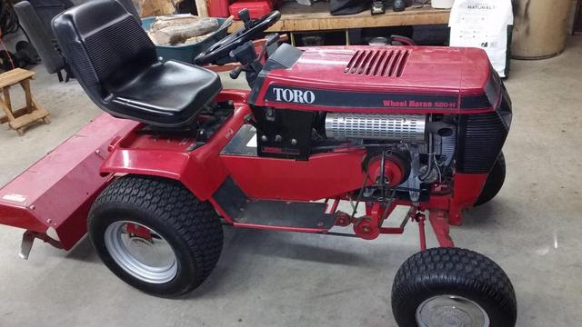

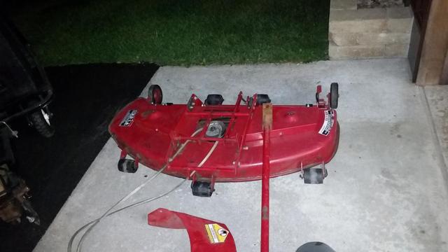

Got myself a RS birtday present...this 520H in northern IL today. The guy had it listed in for sale here so finally got the chance to go see him and make an offer. Over all its in real good shape. 670 hrs on the 220 Onan. Kinda dirty but looks like it will clean up nice. Came with a 48inch deck, blower, tiller, peco bagger vac with a 5 hp Briggs and a cute little generator which the PO never used.  All I  decent shape as well cept for the Briggs needs a new head gasket. Will get some more pics in the tomorrow  in as it was dark out when I got home. I'll be pumping you guys for a lot of info on 520's in general and Onan's as this is my first.

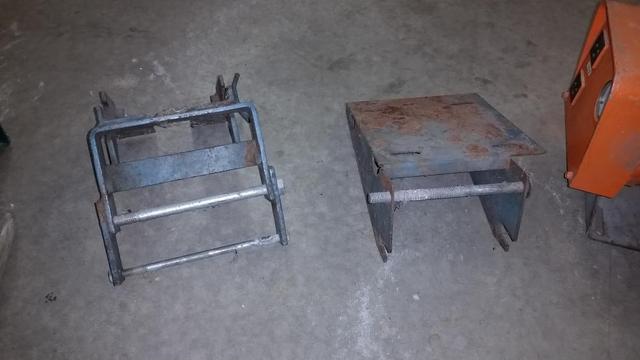

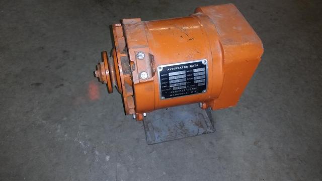

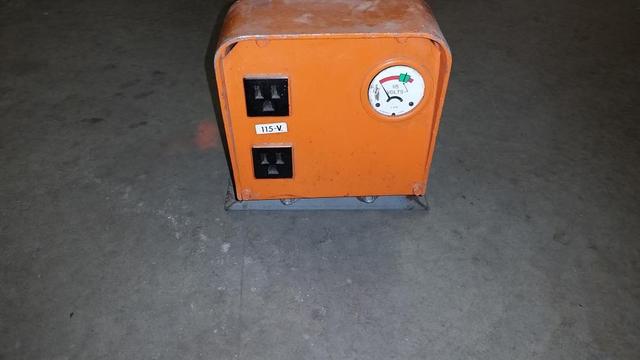

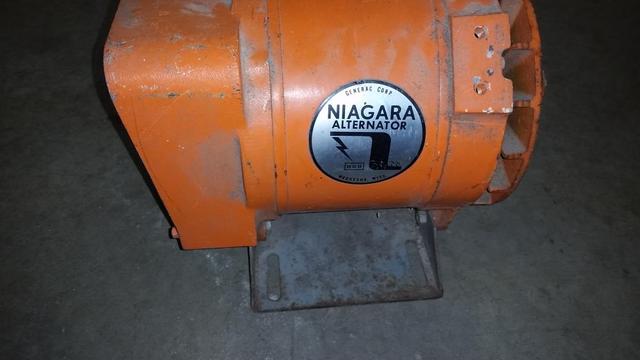

Anybody got any info on this little guy I'm  all ears...the brackets are not home made and look like they go with it and attach to the front somehow. Didn't  have time to dick with it yet. Thinking it might be handy out in the deer woods building stands.

:text-coolphotos:              Nice find; happy birthday to you! :occasion-birthdaymulticolor:  Looks like the generator bracket would hang from the front tach-amatic where the mule drive attaches.  :woohoo:

You hit the Jackpot with all those accessories. Looks good. Clean looking tractor.

Your definition of "kinda dirty" and mine are a bit different...:ychain:
Nice looking tractor!

Dirty, that one looks almost new, you don`t want to see pics of the ones I have bought!!!!!
608KEB
She looks clean!! A little elbowing and you'll have her shined up nice!B)

Ok Ok .. I'm a little anal...OkOk alot anal! Lots of clippings packed around the hydro. I try to hose off  my horses after mowing so the dirt doesn't build up. This tractor really does't have the grease and oil build up I have seen.
I am going to change the all the fluids  because I don't know when it was done last. I plan to use the same 10w-30 in the hydro as in the Onan. Can a synthetic oil be run ok in these hydros? Also if any body has filter recommendations. The hydro has a fram on it now and read here that the right filter needs to used.

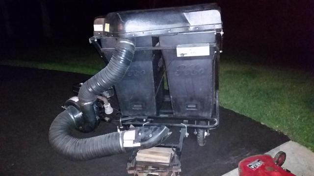

I'm not sure but that generator may have to spin a certain direction? Someone else here will know that. You will like that Peco vac, I have one with an 8 hp and it works great. Great find, sounds like a guy like you will take proper care of that baby!!!

Yes you can use synthetic in the transmission. I have found that Mobile 1 works best in mine. It also helps with the cold weather delay that is inherent in the transmission used on the 520. Also get that Fram filter off of there and put on a Wix or NAPA Gold. Good luck on a very nice find.

Thanks Don, actually was thinking about selling the peco as I really dont have a use for it and already have a WH bagger. Selling it would help offset the price of the tractor.

Don is correct in that generator has to rotate the correct direction.  I see it was made by GENERAC. Their still in business in a big way. The new large  backup generators at my work are GENERAC brand. They have a website .

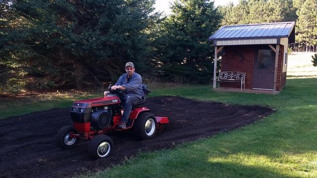

Thanks guys ya the motion lever has gotta go very jerky and I ain't takin the kind ya eat! Bad news is the throttle  cable broke today ...end snapped off at the control so begins  the repair. Did get to till  the garden for winter and the asparagus patch. Will have  to look into Matt's pedal...if it works I could see an issue with the tiller. Lubing the motion  control lever will help but I  just ain't big on reaching under the wheel like that. Same thing as my 246H.

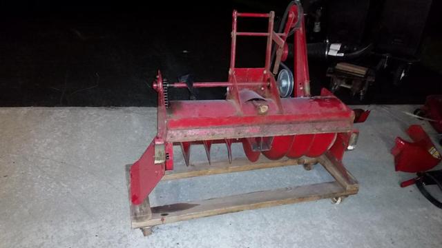

@608KEB you still got that tall chute and would it fit this?

I hear ya Oliver...not a big Generac fan... got boned by them...twice!!
