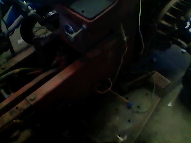

mikehusky455 16 #1 Posted November 14, 2015 (edited) haven't realy had time yet to check into this gt yet working on everybodys snowblowers,but my gt don't have the lift lever for the 3pt hitch,could one similar from a woodsplitter work or is it specific to the tractor,thanks. everything always seems backwords using laptop as camera sorry bout that Edited November 14, 2015 by mikehusky455 Share this post Link to post Share on other sites

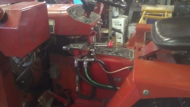

jeremi3210 708 #9 Posted November 20, 2015 Here is what I did with mine. The original one is the mid lift, the two on the side are for the three point and the snow blade angle. 1 Share this post Link to post Share on other sites
