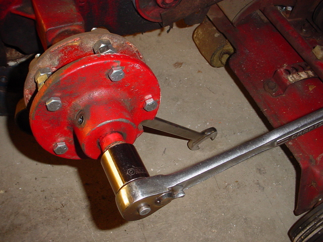

KC9KAS 4,744 #3 Posted November 11, 2015 (edited) @Russ VS do you have an old (spare) hub?You can make a puller out of an old hub using the 5 bolt holes and use a threaded rod for pushing on the axle.You will have more of an equal pull using the 5 bolt design.Someone on Red Square had some photos of this set-up...Maybe they will pust it again, otherwise, do a search on here for hub puller Edited November 11, 2015 by KC9KAS 1 Share this post Link to post Share on other sites

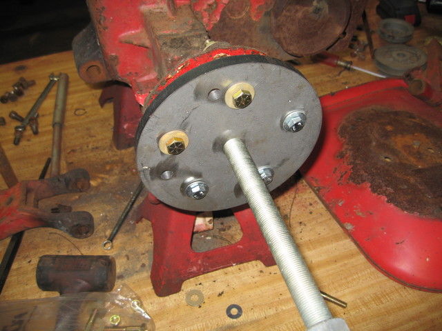

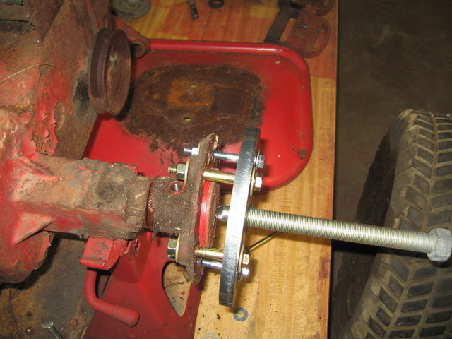

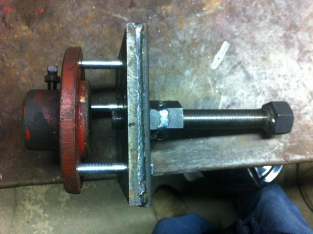

Shynon 7,475 #9 Posted November 11, 2015 I made mine out of 1/2" 2 Share this post Link to post Share on other sites

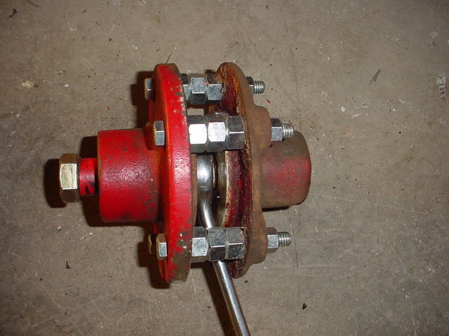

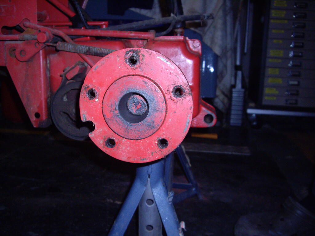

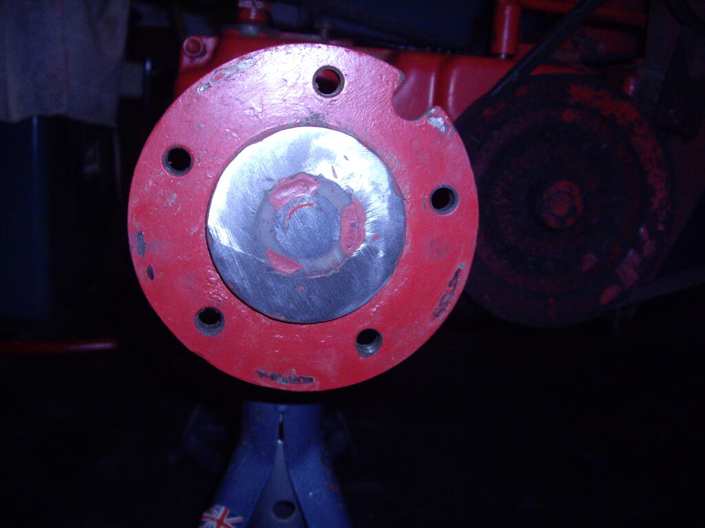

"D"- Man 827 #10 Posted November 12, 2015 I tried the reverse hub method; but, it didn't work on a D-180 with the turning brake disc. See pics. of stress crack in flange. So... I have re-engineered my design to alleviate this via shifting the contact surface area {of the pullers inner plates} to the inner hub surface area as close to the axle as permissible, and the circumferential hex bolts outside of the hub. No pics, as I have yet to remove any hubs with this puller design, since I am still waiting on some of the hardware to finish it. 1 Share this post Link to post Share on other sites
Coadster32 793 #11 Posted November 12, 2015 If you're puller is going to use the threads of the hub that is stuck on the axle....I'd suggest using longer bolts backed up with washers and nuts from the back side as well. Some of these pics have them. It will take a lot of the stress off the threads in the hub, and help alleviate stretching or stripping the threads in the hub. Heat is a big help as well. Be cautious about it though. You will need a good amount, but too much is bad for other things as well.. Share this post Link to post Share on other sites

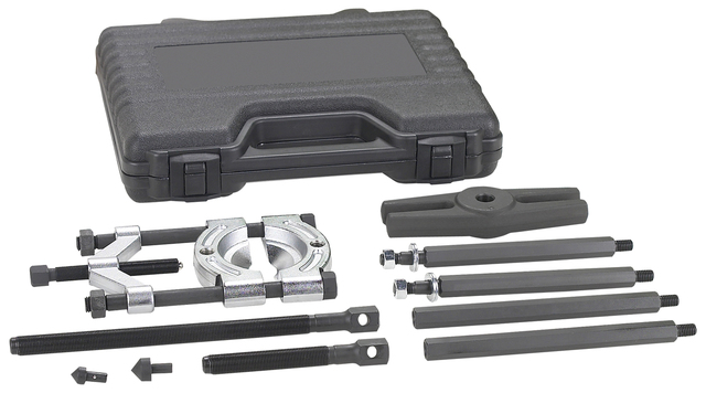

mikekot3 93 #12 Posted November 12, 2015 Here is a OTC push puller and bearing separator tool kit. You can purchase it from places like tooltopia or thetoolwarehouse.net 2 Share this post Link to post Share on other sites
Gary L. 12 #13 Posted November 18, 2015 I use the reverse hub method with 3/8 x 3 1/2" bolts through with 3 1/2" nuts tightened in between the hubs making a more solid and even connection. the puller is a 3/4" x 5" grade 8 fine thread bolt with a nut in between the hubs with a combination wrench on that hits against the floor. I used a cardboard tube that a 3/4" drill bit comes in to keep the bolt centered in the hole..(1" hub) Share this post Link to post Share on other sites
WNYPCRepair 1,923 #14 Posted November 18, 2015 Looks like it was made for the job. Share this post Link to post Share on other sites
953 nut 58,004 #15 Posted November 18, 2015 Considering how hard the turning brake hub is to find I'm glad the puller is the only thing that failed. Check with rental stores to see if you can rent a hydraulic puller and a bearing separator like the one Mike posted. The proper tools will save a lot of agony. 1 Share this post Link to post Share on other sites

can whlvr 993 #17 Posted November 23, 2015 (edited) so this is my homemade puller,it failed me on my newest tractor,c160 8 speed,it bent the 3/4 bolt,ya I had a 6 foot bar on it but it has removed many hubs before,just not the last one,something was gonna break Edited November 23, 2015 by can whlvr Share this post Link to post Share on other sites
