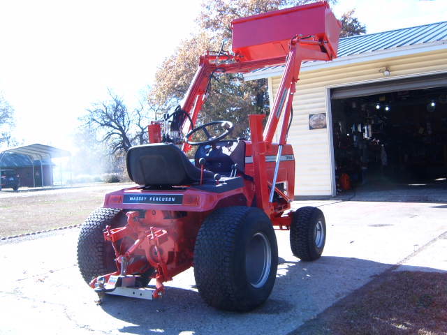

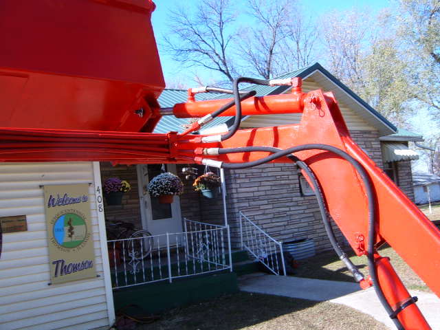

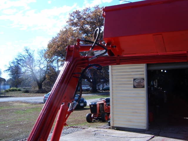

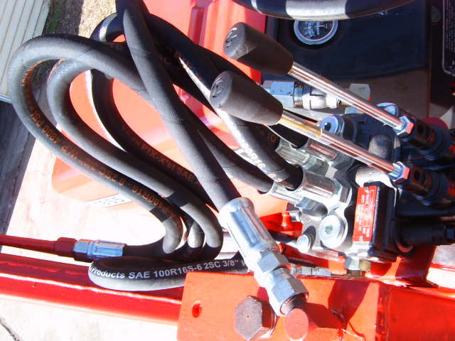

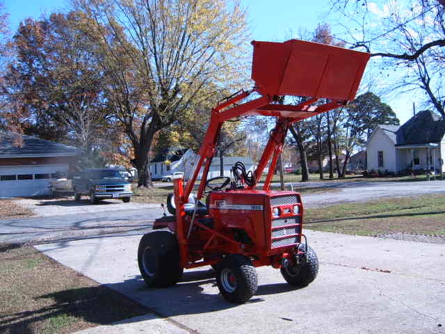

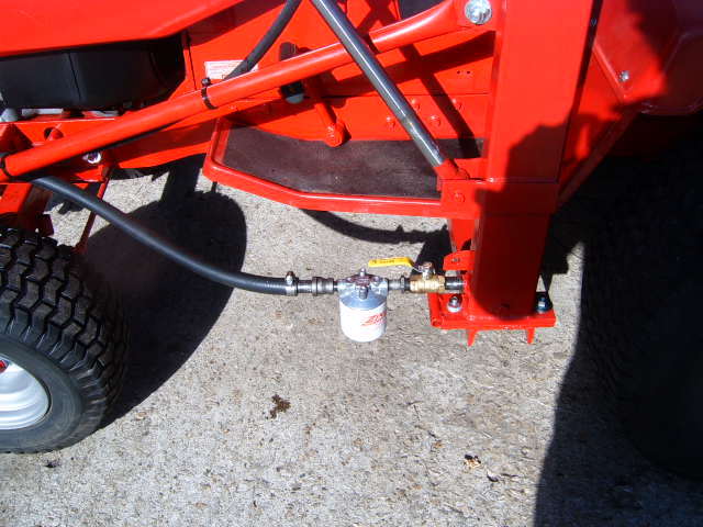

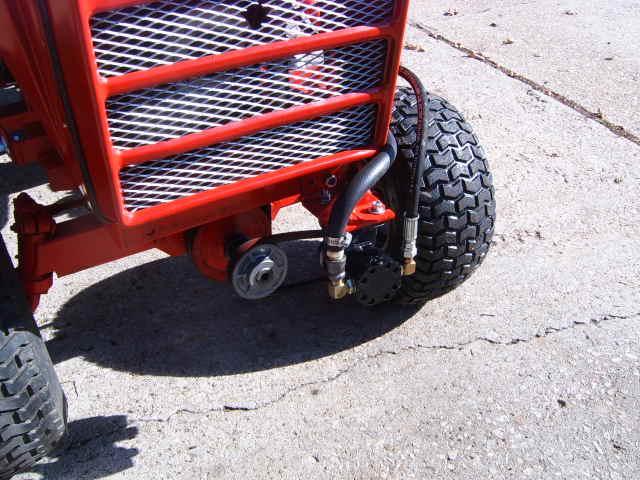

Just got finished with this jewel, 1979 MF 1855 with and ark 550 loader, all new lines, new controls, and new pump. and a complete paint job, enjoy the pictures. I also have a dozer blade for this and a 48in. tiller, and a 55in.rear discharge deck. Oh I also built the bucket .  hope you enjoy the pictures .

Very nice job!  What a beautiful M F     :handgestures-thumbupright:
KC9KAS
Mighty fine looking machine.
Thanks for the photos.
