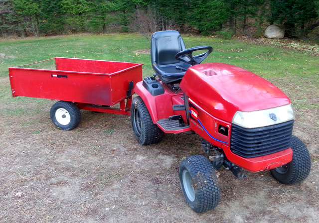

DennisThornton
Starting problem is fixed and I'm in love!  Seems I just need a $10 seal!
But tell me, how do I manage to hit every dog pile with at least two tires!  Can anybody else do that?
I guess it's good I only have Labradors and just "Wheel" Horses, not "Real" horses!
Now, I just need an "xi" series:

slammer302
Looking good!!!:woohoo:How many hours does that XI have on it still looks to be in good condition
DennisThornton
Looking good!!!How many hours does that XI have on it still looks to be in good condition
More than yours!  1162hrs.  More than my Lxi but I think I'm going to clean this one first even though my 520Lxi needs it worse and I got it first but this one will cleanup nicer I think.  I may put this deck on the Lxi and try to find a blade or blower for this one.  I love my C-XXXs and 416 and can't wait to work on my 654 and Lawn Ranger, but these xi's are a huge step up!  I thought maybe I'd never justify a really nice GT and then I found the Lxi.  Figured that was it!  Then this came along...  Who knows?  Might find a 523xi sometime!  Don't tell anybody but I really would like a 345 or 4XX JD.  Or a Case 446 up or newer!  And a D-200, and...  But I digress.
Right now I love my XIs!
