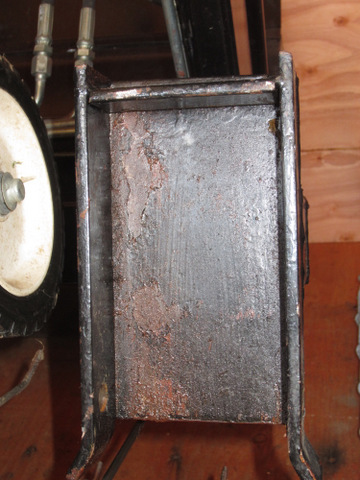

Snowmobileaddict
The $25 was well spent at the sandblaster  shop.  The uprights turned out great and look even better in primer.  I don't know how long they had been done and sitting there waiting for pickup, they never gave me a call to say they were done. Go figure.
For comparison, here are the pre-sandblast pics:
Edited by Snowmobileaddict

Getting the "pockets" for the uprights mocked up for welding tonight.  The uprights are nearly identical.  However manufacturing QA/QC limitations at Kwikway allowed for the reservoir upright to be just a touch wider than the other one.  I'll have to fine tune the fitment on that one to be just right.  Not too tight, not too loose.
The leading edges of the pockets get bent outward too to facilitate mounting the loader.  I'll have to warm mine up and bend them over a bit in the bench vise before welding these together.
typo
