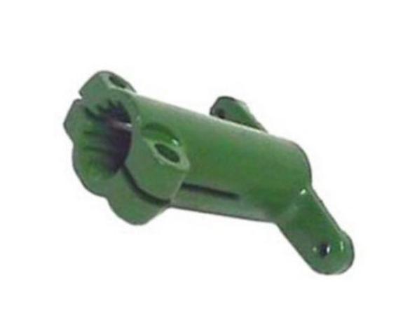

JackC 617 #12 Posted October 29, 2015 (edited) If all you have is the male end of the rotating PTO, I would look for a spline drive clamp on coupler. They are often used when connecting to hydraulic pumps that have splined shafts. That would give you something to attach to. Something like below: Edited October 29, 2015 by JackC Share this post Link to post Share on other sites
tractorhogg 612 #13 Posted October 29, 2015 Thanks a bunch Jack, the two tabs on the front would not attach to anything, or would they? If not would it hurt to cut them off? There are two threads one here and one under implements and attachments. Can a moderator fix it?Sounds like you are missing the female coupling end if all you have is the male end.I will need to find a parts diagram. Wonder how two threads started, I idn't think it was me, but it sure might have been, weird. I have a parts diagram Most of the attachment I am familiar with, like the field mower for the rear end, and the snow blower for the front end, have shafts that slide into the rear PTO or the front PTO. The shaft then goes to a universal joint. I assume you could make a coupler but it would need to be very strong to withstand the torque. One end of the coupler would need a shaft to slide into the rear PTO. There may be a Category 0 rotating PTO coupler available from a tractor dealer or from somewhere. You could also make a coupler from a universal joint.What are you trying to attach? I havent' attached anything yet, I was hoping to use a finish mower or brush hog Share this post Link to post Share on other sites
