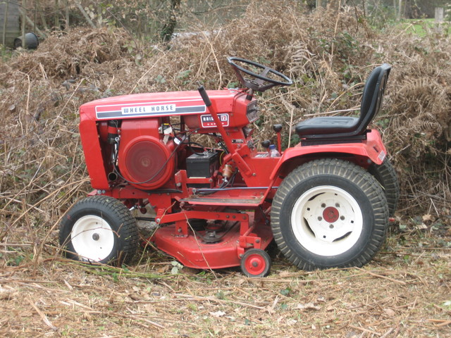

I'm hoping that someone may be able to point me in the right direction here.  I recently restored a Raider 12 and ran it around the garden briefly before taking it to bits and then out to France where I put it back together again.  That was this time last year and I cut about half an acre of brambles and bracken.  It was then used again in March and June with no problems, but recently having used it again, it would not start after a run.  The starter was not turning and no click from the solenoid, but it started first go with jump leads onto the car and then stopped as soon as they were removed.  I charged the battery which is only a year old and it worked fine.  I guess it's not charging and that I have just been running it from the battery all the time.
What I have remembered from when I stripped the machine down was that there was a question about this, but when it all went back together and ran ok I forgot all about it.  I did measure the resistance across the alternator coils at the time and there was continuity but I can't remember the resistance reading.  When the engine is running at idle speed the ammeter oscillates quickly from positive to negative but this stops when the engine revs are increased and settles down to a small discharge current, about the thickness of the needle.
Any suggestions what this could be?  The problem I have is that I am not going back to France for a few months and would like to take the necessary parts over to fix it.
Also I have just bought a tiller to go on the back and will need some advice on the lift mechanism, but will put this as a separate post.
Any thoughts would be appreciated.
Andrew

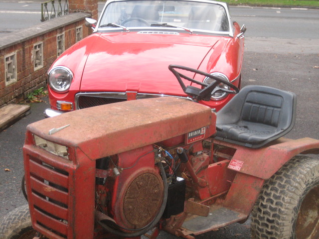

Sorry for the off topic post, but what year is that MGB? I miss mine.... :(

The answer to the question about my MG is that it is a 1980 model.  I'm sure someone will notice that the bumpers are not the standard black rubber things that had to be added to keep the U.S. regulators happy.  Unfortunately changing the bumpers is not quite as simple as a straight swap.  The front wings also had to be changed to ones with holes for the indicators and side lights, not that that was a problem as I replaced all the external panels except the bonnet and boot lid.  The ride height was also raised on the rubber bumper models and that has been corrected with new springs front and rear.
