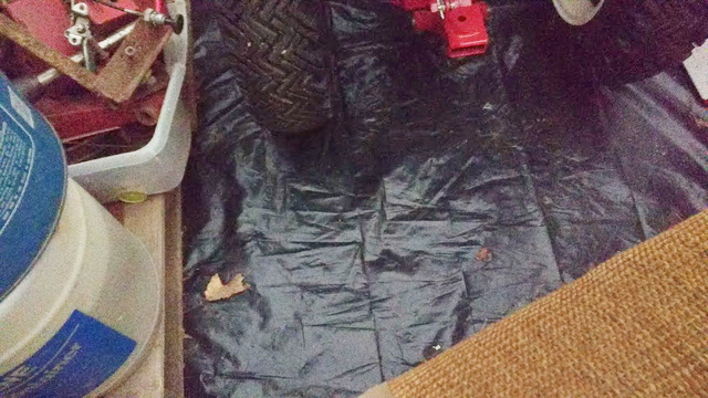

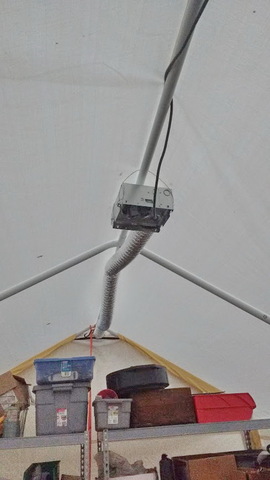

rmaynard 15,427 #8 Posted October 23, 2015 (edited) I put one of these garage-in-a-box up last year. Because I did not have anything covering the dirt, the inside of the tent became a sauna. The humidity got so high that it literally rained inside. I did not realize it until I went out to get something last winter and everything inside was covered with ice. All the cardboard boxes and any papers were ruined, and unprotected steel was rusting. I corrected it this summer by removing everything and putting down heavy plastic to cover the dirt. Then I put a bathroom exhaust fan in the ridge and vented the air out via a 4" duct, similar to how you vent an attic. So far, no moisture this year. The fan uses a couple dollars per month of electricity to run 24 hours per day, but it's worth it.So bottom line is, if you don't want your horse and their accessories to be ruined by moisture, put something down on the ground to seal the moisture.Here is a picture of how I installed the exhaust fan ($13.00 from Lowe's)And here is the heavy-duty black plastic on the ground. It is a one piece installation so I didn't have to tape any seams. It is thick and will take a minimal amount of abuse. Edited October 24, 2015 by rmaynard Add photos 8 Share this post Link to post Share on other sites

rmaynard 15,427 #15 Posted October 24, 2015 I added some pictures of how I handled my moisture problem. It's a cheap fix. http://www.wheelhorseforum.com/topic/59791-wheel-horse-storage/?do=findComment&comment=551581 1 Share this post Link to post Share on other sites

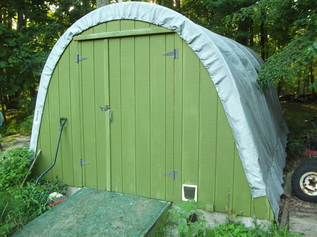

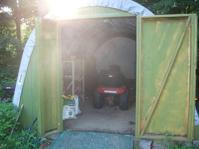

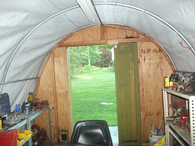

Sparky-(Admin) 21,300 #20 Posted October 24, 2015 I put my 12x20 Shelter King on a 12x20 pressure treated deck with a plywood floor. I get about 4 years to a top before the UV rays ruin it. The zippered front door finally gave up as well so a wood wall with a door replaced it.Mike.......... 6 Share this post Link to post Share on other sites

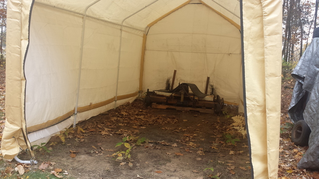

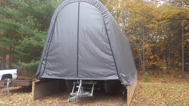

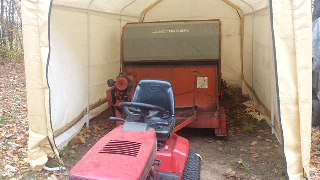

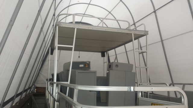

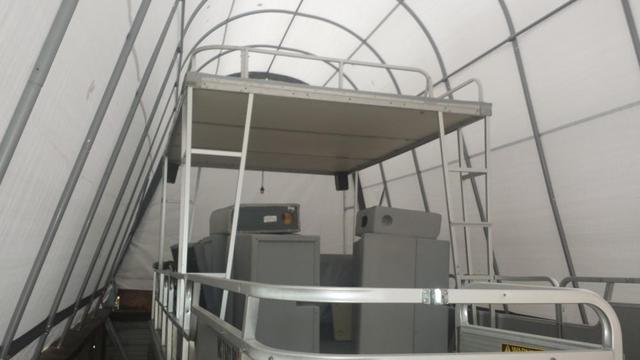

kiotiken 105 #21 Posted October 24, 2015 I like the creative ways you guys put up your garage in a boxes.It gives me some ideas for mine.Hadn't thought of putting plastic down. And Sparky's wooden front panel looks good. Here's a couple of mine that I put up. the first one is from HF and I got it off Craigslist for 75 bucks. I use it to keep the main shop open.I have my 72" finish mower and the Jacobsen sweeper.I use to just tarp them put the HF garage works good for keeping them out of the weather. My second one is Menard's garage in the box. It;s 14 x28 x12. I wanted it so I could put my pontoon in.The toon has an upper deck and was really hard to tarp up after using it on the lake. When I got it home and started putting up I quickly found out it wasn't high enough for toon to get in. Momma was not happy making the purchase and seeing it wouldn't fit. But I wasn't deterred after thinking about I built a wall and set the shed on top. Check it out. 4 Share this post Link to post Share on other sites

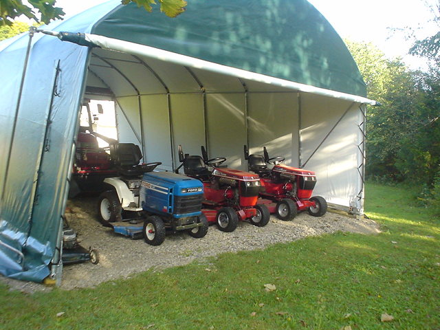

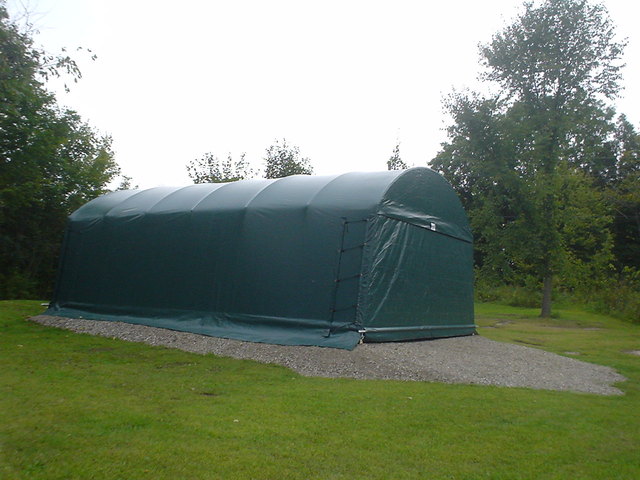

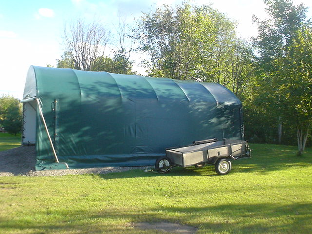

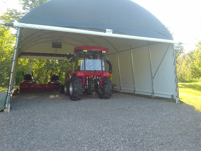

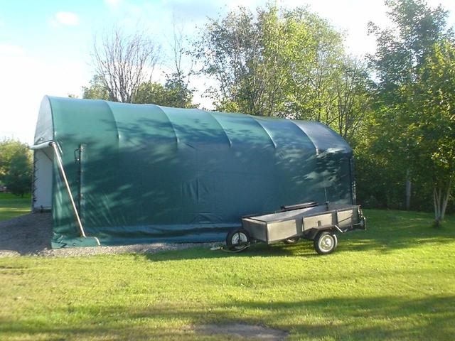

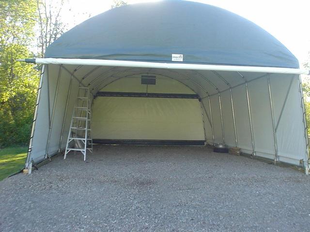

cleat 5,809 #24 Posted October 24, 2015 (edited) I put up an industrial strength tarp top building last year. it is 20' x 30' with 8' high doors.It has 3 or 4 dump truck loads of crushed stone under it.For the first few months it got quite damp inside but that stopped once the ground under it dried out. It seems fine now.Cleat Edited October 24, 2015 by cleat 4 Share this post Link to post Share on other sites
Brian01 481 #25 Posted October 24, 2015 Dang that's huge...whatd that one cost Cleat? Share this post Link to post Share on other sites
