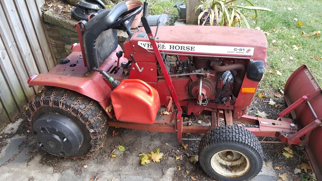

One of my neighbors is trying to offload a C-81....for free. He just wants me to get rid of it.
I don't have a big property and most of it is rocks.....but I could see using this to plow my rather large driveway although I'd need to buiild a shed to store it.

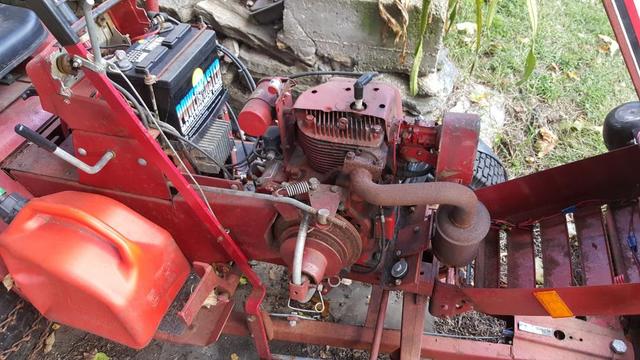

As a newbie I'd like to ask for some help. Currently the tractor doesn't start. Previous owner says he can see the fuel filter isn't showing any activity so my guess was that it's the fuel pump that needs to be replace. Engine tries to crank but it's most likely not getting any fuel.
Any help is greatly appreciated. He added weights to the rear wheels, filled the wheels with windshield washer fluid, and it has chains. Also has the mower attachment. 8HP. I haven't taken possession of it yet because it's at the bottom of a steep driveway so it will be a royal pain to push it up to get it out!

Pics.

IMHO - a C81 is a very good tractor.  It will make a great snow moving machine.  Once you get accustomed to it, you will likely find it useful for other chores.
Get the tractor!
:WRS:    You have come to the right place. It isn't too unusual for a :wh: that has been sitting for a while to have fuel issues, the ethanol fuel being sold today will eat rubber fuel lines. Start out by removing any fuel from the tank and replace the fuel line and filter. Also, remove the carburetor and clean it up with a little lacquer thinner and put in a new needle and seat. You can get a kit on :techie-ebay: for around $12. When you fill the tank you want to use ethanol free gas, go to buyrealgas.com put in your zip code and it will let you know where to find it.

Take the machine.  It looks in pretty good condition (much better than the C101 I restored this past spring).  Everything all the other posters said is good info.  However, although you likely have a fuel delivery problem, you could also have an ignition problem.  A quick way to tell is to remove the spark plug and put about 1cc (a teaspoon) of gas down the spark plug hole.  Put the plug back in and put the plug wire on and crank away.  If the spark is good, the fuel will ignite and the engine will run for a few seconds.  Then you know it is a fuel delivery problem.  It could be a fuel pump (after all it is about 37 years old).  Also, if the vent in the gas cap is clogged, the fuel pump cannot pull the fuel forward.

After you've tried Doc's suggestion, and it fires/runs...
You should be able to pull the old fuel line from the carb,
and hook up a temporary line that gravity feeds from a fuel can...
to drive it up that hill, and start your :wh: addiction. :handgestures-thumbupright:
Good luck...let us know how it goes.

Mostly what they already said.  The real concern is not the C-81 but what will become of you!  Especially if you hang out around here!
But, it's most likely too late for you so back to the tractor.  Pull the plug wire and test for spark with a used plug or tester if you got one.  If you have a good spark:
Pour a little gas down the carb, choke it and crank.  Most likely you'll hear a very satisfying sound and your disease will progress.
Drain all the gas from the tank, lines, filter and fuel bowl. Check 'em, clean good, blow them out, make sure the float AND needle will move up and down, put 'em back or replace the lines and filter.  Put some fresh gas in the tank, dribble some more in the carb, crank again and hopefully drive it around.  Then you will be hooked forever.  If not come on back or run for your life while there is still hope!

Awesome. Thanks for the warm welcome and the great advice. Battery is also dead. And it's probably been a while since the po tried to start it.
