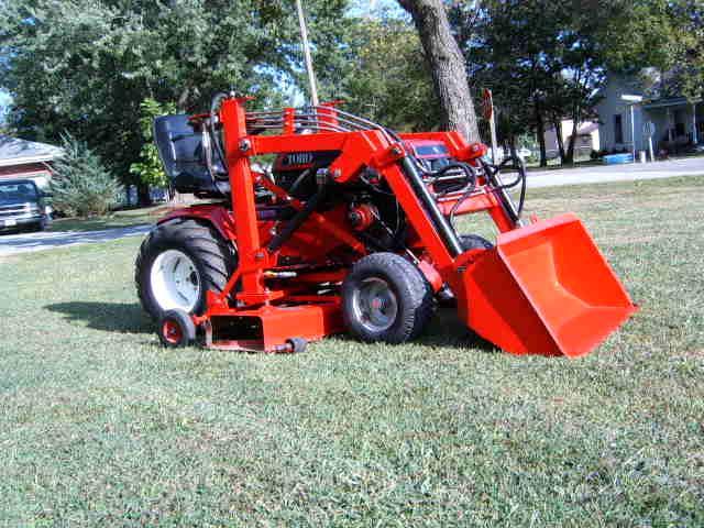

c-series don 9,252 #12 Posted October 16, 2015 Ok Elloit how did you get the loader and mower deck on at the same time? How do you run the loader without the blades spinning? I have to say it looks cool and I want to know how it works? Share this post Link to post Share on other sites
boovuc 1,090 #13 Posted October 16, 2015 Congrats on the buy! Just take your time on it. Micro-Compact Loader-Tractors are very unstable on uneven ground. With a load on the bucket, be careful on hills, slopes and uneven surfaces. And above all, have fun with it! 2 Share this post Link to post Share on other sites
bmsgaffer 2,046 #14 Posted October 16, 2015 Ok Elloit how did you get the loader and mower deck on at the same time? How do you run the loader without the blades spinning? I have to say it looks cool and I want to know how it works? He's running the loader off the flywheel side. Build details here: http://www.wheelhorseforum.com/topic/58563-building-a-loader/ Share this post Link to post Share on other sites
elliot ness 1,916 #15 Posted October 16, 2015 Ok Elloit how did you get the loader and mower deck on at the same time? How do you run the loader without the blades spinning? I have to say it looks cool and I want to know how it works? I ran a pulley off the left side of the Onan so I have full time live hydraulics, and can still run the 60in. deck off of the right side with the clutch. I posted pictures of it 2 mo. ago I think I called it building a loader, you can look it up and see my steps as I built it. But I will say the deck gets in the way when you get serious about moving 20 ton of gravel. so I took the deck off. I only built it this way to prove a point. Share this post Link to post Share on other sites

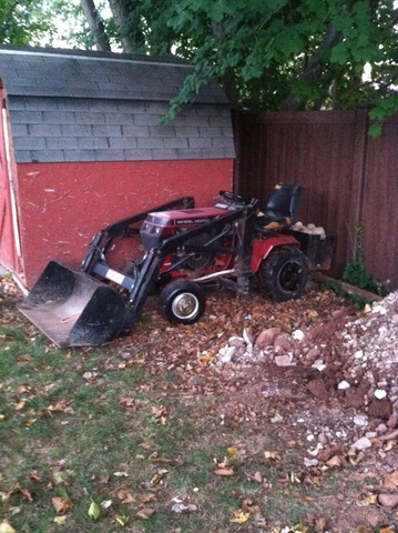

yzf450motoxrider 20 #17 Posted October 20, 2015 Here it is. Not pretty but it works. Already used it to move gravel and dirt around, works great.. 6 Share this post Link to post Share on other sites
AMC RULES 37,144 #18 Posted October 20, 2015 Nice looking there... I see, like me... you need another shed. Share this post Link to post Share on other sites
roadapples 6,983 #19 Posted October 20, 2015 Nice looking there... I see, like me... you need another shed. Yea, that's not quite gonna fit. 1 Share this post Link to post Share on other sites
yzf450motoxrider 20 #20 Posted October 20, 2015 yea the shed is on the list for next year. The 314A takes up most of the space. Share this post Link to post Share on other sites
muz123 1,192 #21 Posted October 20, 2015 (edited) Sweet 520! Must be fun to use!! Edited October 20, 2015 by muz123 Share this post Link to post Share on other sites
yzf450motoxrider 20 #22 Posted October 20, 2015 its a blast! Looking forward to using it in the snow. 1 Share this post Link to post Share on other sites
WNYPCRepair 1,923 #23 Posted October 20, 2015 Looks great. Well worth it, in my opinion. Share this post Link to post Share on other sites
bmsgaffer 2,046 #24 Posted October 20, 2015 Granted, its from far away, but that doesn't look nearly as bad as you described! Great find! Share this post Link to post Share on other sites
