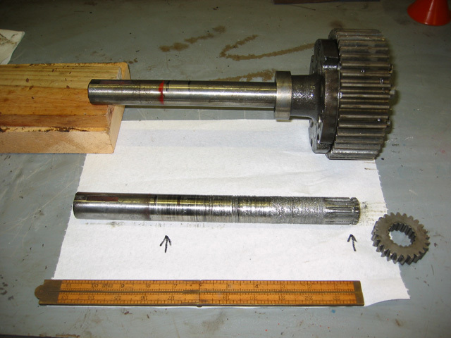

Ok this may be a stupid question coming from me but I really need to replace the Axle bearings in my 654 and I bought the KOYO B-1616 Bearing to do it with long with the seals to go with axle. Now the question is DO I Really have to pull the tranny then split it just to replace these bearings or is there and easier way You Ole Horse Junkies know of? Bud Andrews or one of you ole timers LOLOLOL

Seals you can do with out splitting ...bearing you have to split...besides if your needle bearing has failed you should really look around inside to make sure it didn't damage anything like this one did...
